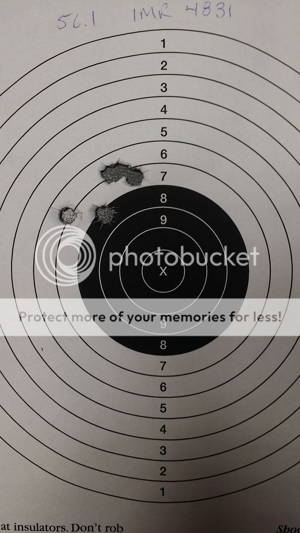

In a weak moment last week I bought a Ruger American Ranch in .223 from my local Canadian Tire, its the one with the 16" barrel. Its gonna be my coyote/truck gun. I Put a Bushnell AR/223 4.5-18 X 40 mm scope on it. I was a little concerned when my groups while sighting in with Rem UMC 55 gr and Fed Fusion 62 gr where in the 2" range. Then for ####s and giggles I tried some Win 45gr JHP I had on hand, I wasn't expecting much as this rifle has a 1/8 twist and thought it might be too fast for the little 45gr pills but I was happily surprised when I got groups in the 3/4" range at 100 yards. Next set of days off I'm gonna start working up some handloads. Very happy with this little gun so far. Only issue was there was a little bit of contact between the stock and barrel at the front of the stock but this was easily and quickly remedied with some minor sanding with a dremel.
That darn Win 45 grain stuff is extremely accurate in both my .223 and 22-250. I haven't even reloaded for those cals since I came across it, to be honest.
You found an excellent load IMR 4895 and may never need to try anything else. Did you vary any of the other powder charges to see if they are capable of producing better accuracy...?
