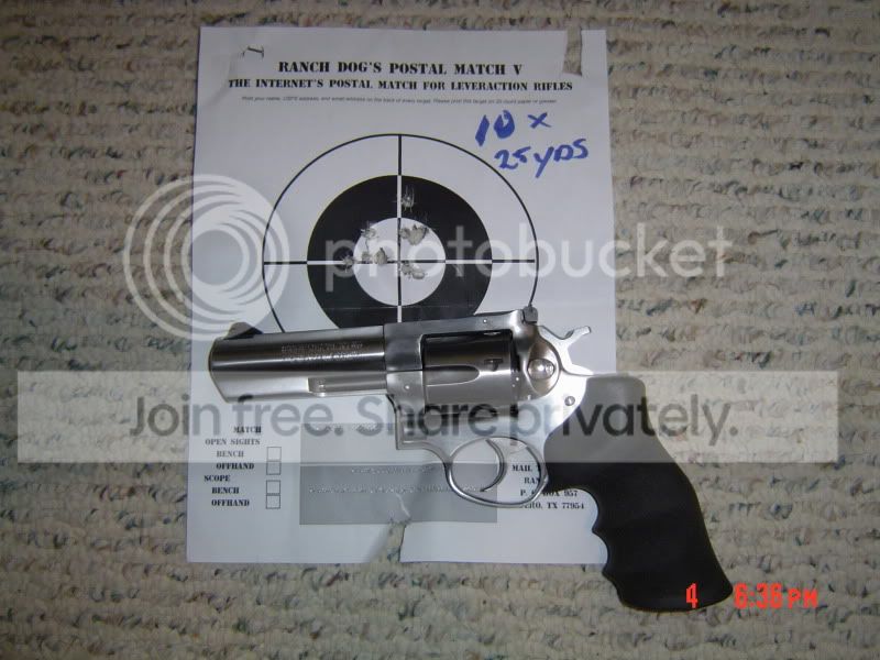

I fired 156 rounds through the gun. From a rest I managed a 1.25" group at 25 yards using my load of 3.5 gr of Clays under my 160 gr LRN boolit. This load makes PF of 130 out of the gun. Interestingly the average velocity out of the 4.2" Ruger was identical tp that achieved out of my 6" S&W K-38. 25 yards from a rest I managed a 1.5" group measrued center to center. Avg vel of 827fps with a SD of only 9.

Here she is with my 25 yard target shot from a rest.

Looks good Bob, if I was in the market for a shorter revolver right now, that would be the one I would get. Actually, if I was in the market for a longer revolver I would still get the GP100.
Check out the Williams Firesight to replace your front sight with a fiber optic sight that should just drop in and replace the Ruger stock sight.
