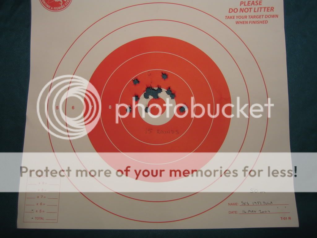

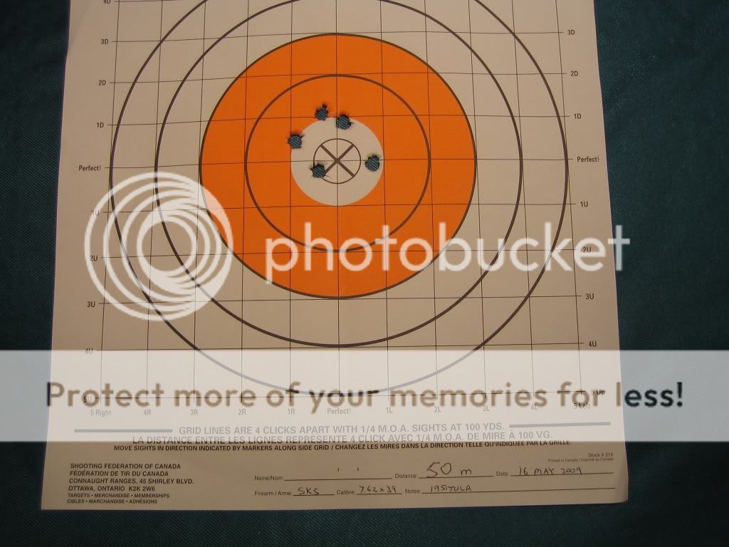

I think I'm happy with how mine shoots :D
50m, 5 rounds:
50m, 15 rounds:
Tried shooting at 100m but how the hell does anyone actually see where on the target paper they are aiming with open sights at that distance? Maybe my eyes are just bad???
