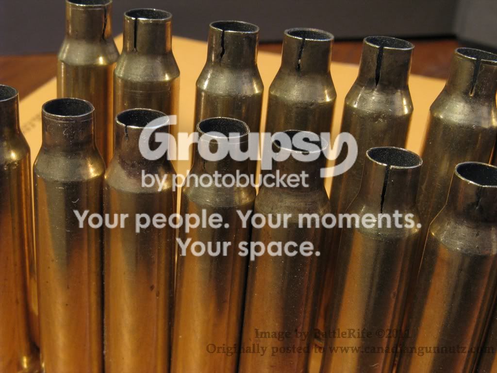

I have once fired .222 Sako brass from the 50's and after first reloading the cases split?They are in an orange and blue box..........Harold
Most likely they have picked up a corrodent that has induced stress-cracking. Annealing will reduce the stress and eliminate the problem, but it wouldn't hurt to thoroughly wash and tumble them, too.

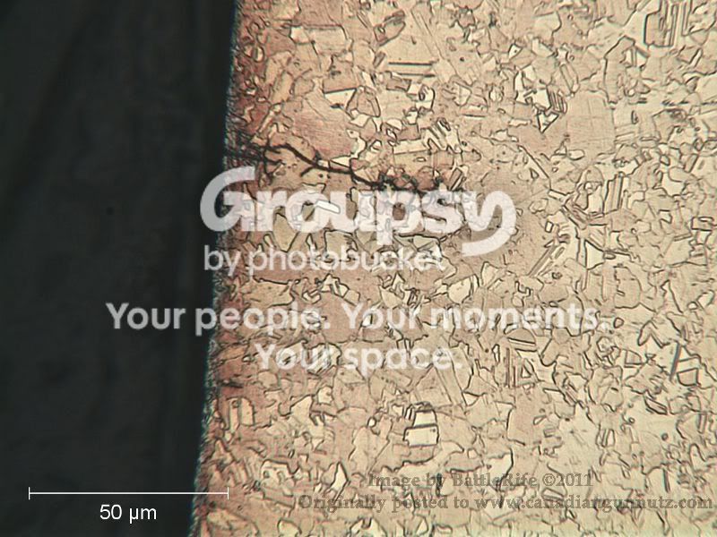

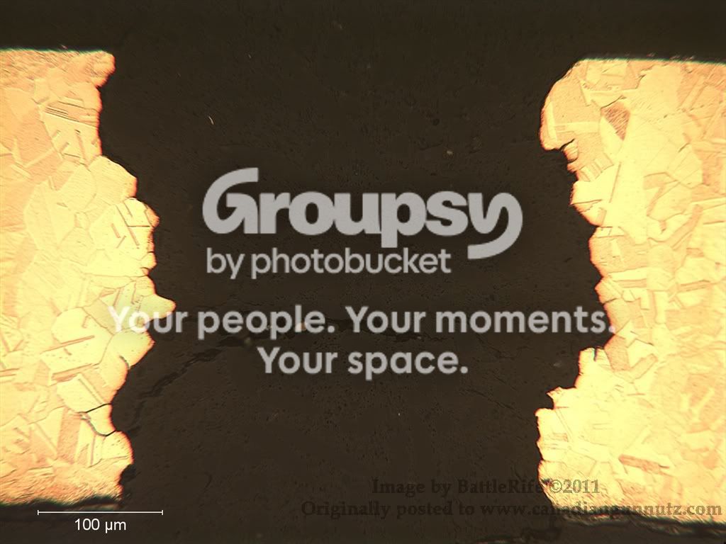

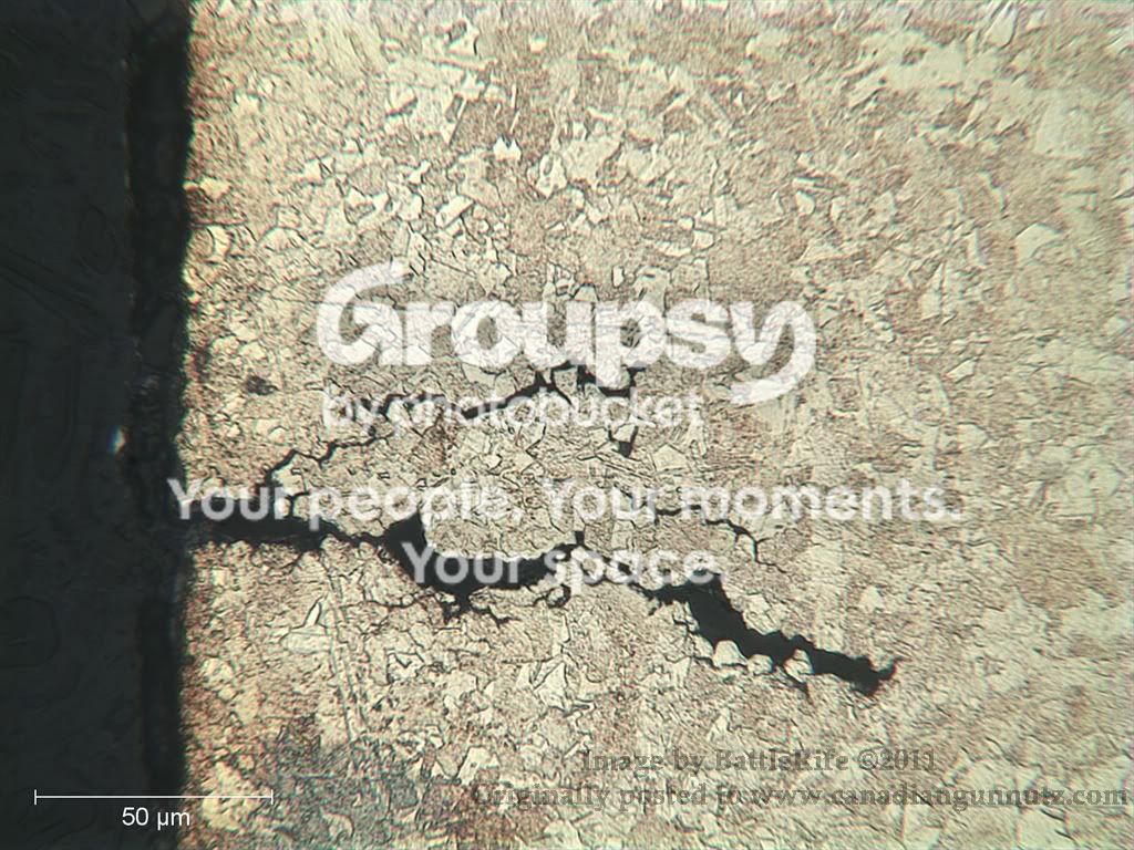

If you Google or Wikipedia "season cracking" you will find that it is an obsolescent term for the mechanism that is now known as stress-corrosion cracking. Stress-corrosion cracking was what I meant to type when I wrote "stress-cracking", but my mind got ahead of my fingers. A corrodent is required, stress alone will never cause brass to crack by itself. Ammonia, nitrate and mercury compounds are all notorious at cracking brass. The case will not necessarily look corroded, it simply cracks as the corrosion is focussed entirely at the crack tip. Microstructurally, the crack cleaves through the brass grains or separates them from each other, leaving a very brittle looking fracture, but if you do an impact test on the material it is not brittle. It looks like this:
And funny you would bring it up, but it so happens that I do not believe in work hardening, at least as a common failure mechanism in brass cartridge cases. Lots of tests have shown rifle cases will take dozens of loadings in a short period without cracking, but if I load them then store them, sometimes they fail in as few as 3 loadings. I have looked at the metallurgical condition of enough of my failed cases (and cases that were fired a dozen times without failing) to convince myself that if they failed in less than 20 cycles, they didn't fail by work hardening. Some people get that kind of life, but apparently something in my basement or my reloading/shooting routine is contaminating my brass.

The granular makeup of the picture that shows complete separation appears different from the splits. Was that a lower case separation? Excellent pictures by the way.
