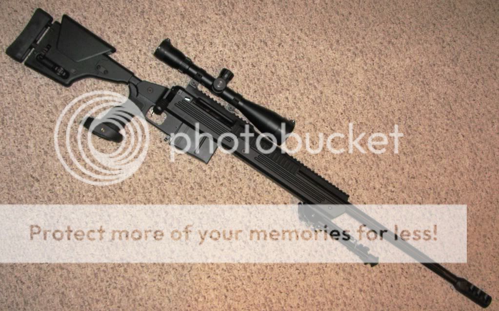

Savage 10BA .308
Bushnell Elite 6500 Tactical 2.5-16x42 with Mil-Dot reticle
Millett Tactical 30mm Low Rings
Magpul PRS-G3 Buttstock
Burris 9"-13" bi-pod (also have a Harris 6"-9" bipod for benchrest)
One of the most accurate and best built rifles I have ever owned.

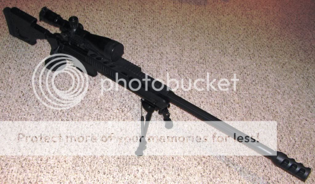

Savage 110 BA with a Bushnell Elite Tactical 4.5-30x50 Mil-Dot scope and bi-pod of course.
Going to go buy a damn shelter soon so I can shoot in the rain if I have too :)
