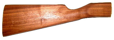

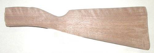

Unfortunately, i think the butt stock is toast. It's got a good floppy crack at the tang, and the rear (where the tape is) is all cracked to hell and back....
Also the tang is indeed drilled and tapped. Looks factory done, its got the little screw blanks in the 2 holes. I assume it was for a Weaver style base or maybe for aperture sights...
Neat Prewar 99E. The rear drilled holes are factory and are for a tang / receiver sight. Lots of available models / styles that will fit those holes. Finding a good used stock is difficult. If the stock is in good condition then usually so is the the rifle. There are a few companies that make replacement stock sets. I think that you can get a set for about $150 US. There are are few people in Canada that will do stock duplicating, not sure how expensive it is. With a 30-30 it is better logic than a 303 sav to spend a couple of bucks on it to make it a shooter. Good luck sprucing the old girl up! Post pictures when you are done.
