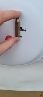

Good to see you could make it usable, which is actually surprising any portion of the barrel was okayFinnaly got to shooting some different ammo brands after my hacksaw and brass screw crown job.
No didn't measure it. But the bullet would go right in there easily, not it won'tGood to see you could make it usable, which is actually surprising any portion of the barrel was okay
