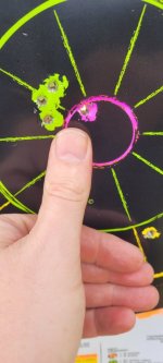

So decided to go and chop the barrel down. Had to go back to 18 1/4" before I got to the rifling. The pic is at 100 yards with AR223 ammo, went from a group size of about 12 inches to a thumb lol. Not to bad for a hacksaw, a file and a brass screw with a little valve lapping compound. I think it looks better with the shorter barrel20241003_143725.jpg 20241003_143026.jpg
OP - way back in the day - circa late 1970's, I hacksawed off a Remington 788 243 Win barrel from 22" to circa 18 1/2" - used various stuff to try to get the cut to be square to the bore hole - the barrel outside was tapered, at that point. I used a "Smooth" file to dress off the muzzle - then went to the range with that file - shot it - as I recall there was like a "star" shape of soot on end of muzzle - started out not very even - touched up with file and repeated - eventually got the "star's" "legs" to look similar - then fired for group. I shot many 3/4" and 5/8" 3 and 5 shot groups at 100 yards with it. I do not recall doing anything more to that muzzle, although I might have. My wife used that rifle to get her first and only mule deer buck - our son used it to get his first white tail, and our daughter used it to get her one and only white tail - although it had a 308 Win barrel, by the time our daughter used it.
