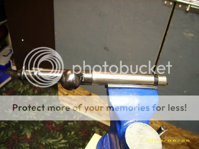

Now if you look at the bottom of the bolt you will see a squared shaft on the bottom, which is what I used to hold it into the vise.

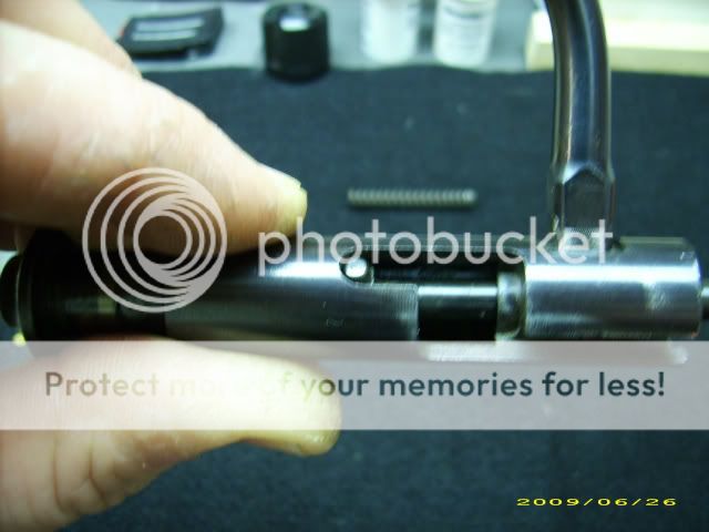

Now if you pull GENTLY on the back of the bolt you will see a little flat sided shaft in there (5/16 sized) it turns out counter clock wise.

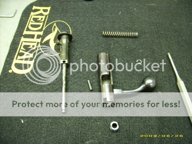

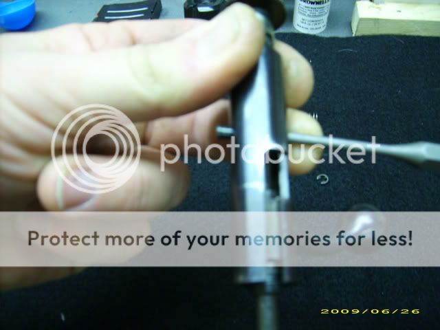

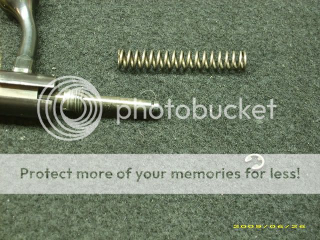

Once you have the two halves of the bolt apart you will see a shaft (on the part of the bolt that has the bolt handle) that has a spring and a retaining snap pin on the end. I used a flat head screwdriver to slip the snap ring off while I held the spring with my fingers.... I have pretty tough fingers, so if you have any doubts, put the end of the shaft down on the table or bench before you slip off the snap ring. THIS UNDER TENSION!!!! If you are not careful you will have parts across the room!
You will now notice that the bolt in no longer under tension, this is useful for removing the pin that holds the centre shaft in the bolt body. There is a corresponding hole on the bolt body on the other side of the pin, but you have to rotate the bolt a bit and push it rearward so that the hole line up. The pin has a head so it should only go in and out one way.
Now you have the bolt assembly completely apart. If you were cleaning the bolt this is where you would stop.

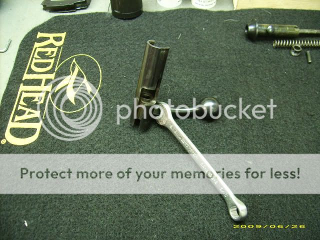

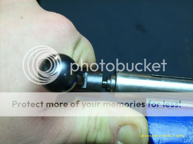

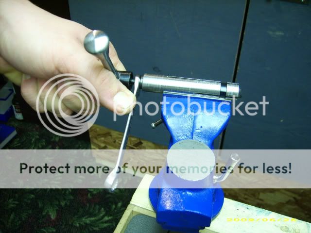

Now we take the 5/16” wrench to the bolt handle, again it is a standard lefty loosie righty tightie thread.

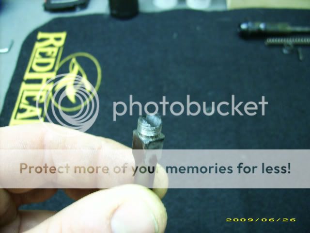

Now you will notice why we couldn’t just unscrew the bolt handle in the first place, there is a relief cut into the threads of the bolt handle to make room for the centre shaft that strikes the firing pin.

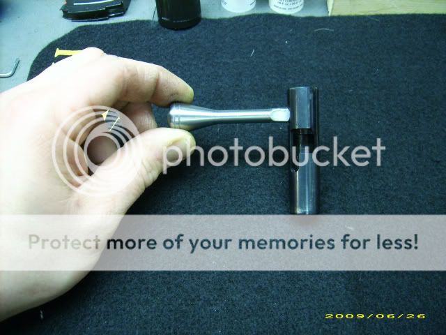

For the replacement handle we had the machinist make the threaded portion that threads into the bolt handle only long enough to reach the point where the old bolt handle started its relief. (Sorry no pics of that ) Now you apply a bit of lock-tight (I used red) to the threads and turned it in by hand until it was finger tight then gave it another turn, I then looked inside the bolt body to ensure that the new bolt handle will not be in contact with the moving parts inside.

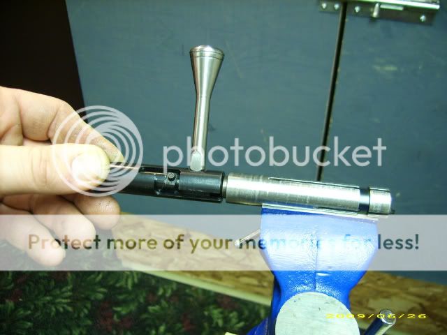

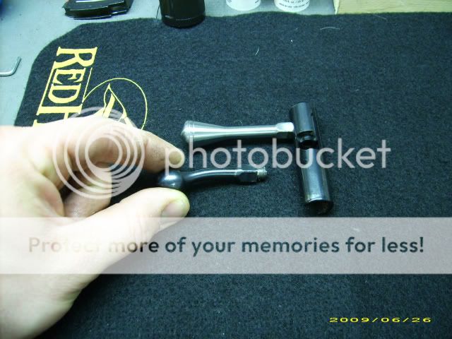

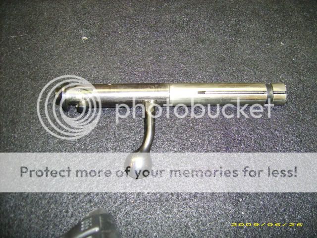

Here is a comparison between the two bolt handles.

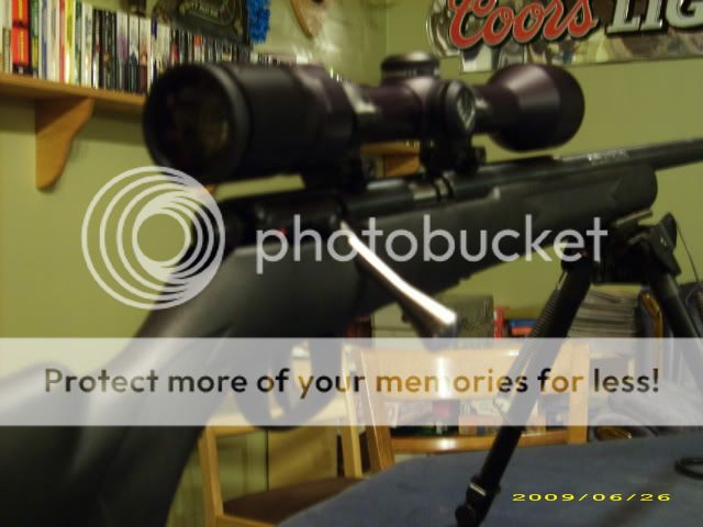

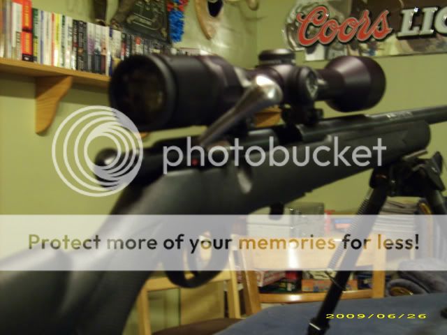

This is what it looks like all put back together.
I haven’t had a chance to shoot it yet, but I don’t imagine it will hurt the performance of the rifle what-so- ever.
