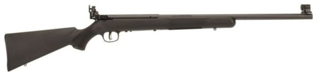

Problem is, for all i like about this little rifle, it started failing to extract.
I've surmised that it is not the extractor or the firing pin (serves double duty as ejector) and it's not a dirty chamber.
What I have found is that the red follower the round sits on before chambering is sitting just high enough at the chamber throat that it is actually catching the back of the lip of the shell casing, preventing extraction. This was with Winchester 333 22LR
I switched to CCI brand and improved but still had to pop the odd case out with the jackknife.
I took it apart and am looking at this long plastc unit that is the follower assembly and wondering if I should just shave that front lip on the follower.
Also notice that plastic thing is slightly twisted, making the follower sit higher on one side.
I googled Rascal extraction issues and seems many folks have a similar issue but they are looking at the bolt and many are not solving thier issue. Makes me wonder if these other rifles have the same problem mine has and it is being overlooked?
My brain tells me to yank that plastic follower assembly and make a new one out of aluminum LOL
I am not gonna bother with Savage warranty over a rifle this cheap either
anyone else find this problem?
I had the problem, spent a minute or two sanding down the follower and is now good to go.
