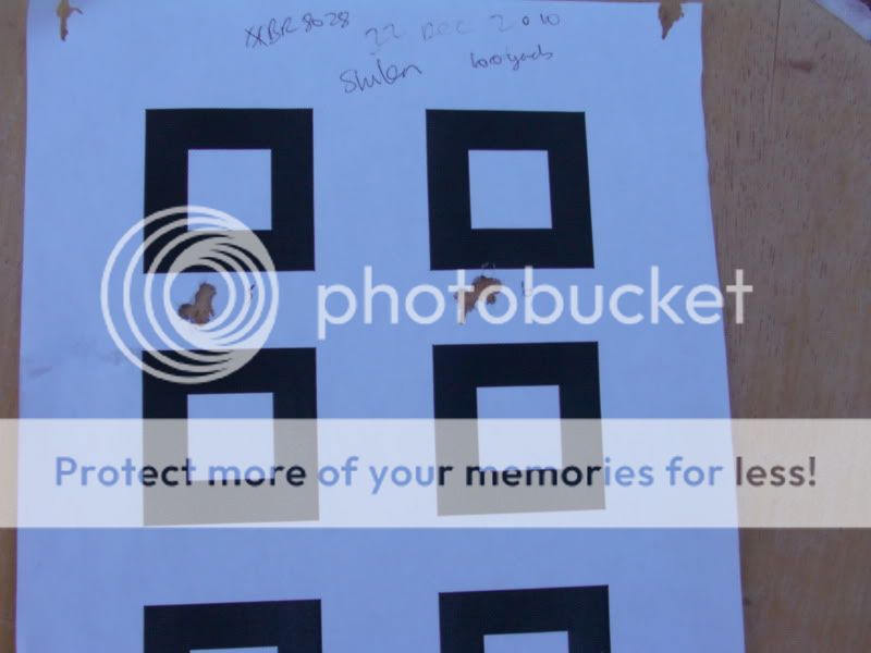

Greg,
if you have not already tried then play around with loads. I have a Shilen stuck on a stevens 200 action. Once I found out it liked SMKs 69 and 80 grain and IMR 8208 it shot really well. It hated Amax and it was not as good with varget.
It shot the 69 grainers like this with almost any charge. If I posted amax groups you would think it was a shotgun.

It's really hard to get the 69gr SMK's to shoot bad... My factory tube loves them as well as the 75gr Hornady.
Thanks for that. I have about 450 69gr SMK's, the 50 I've loaded up haven't shot as well as yours!! I'm using H4895. I also have Varget available to me. I think My next reloading session I'll focus on the varget and see how it treats me.
