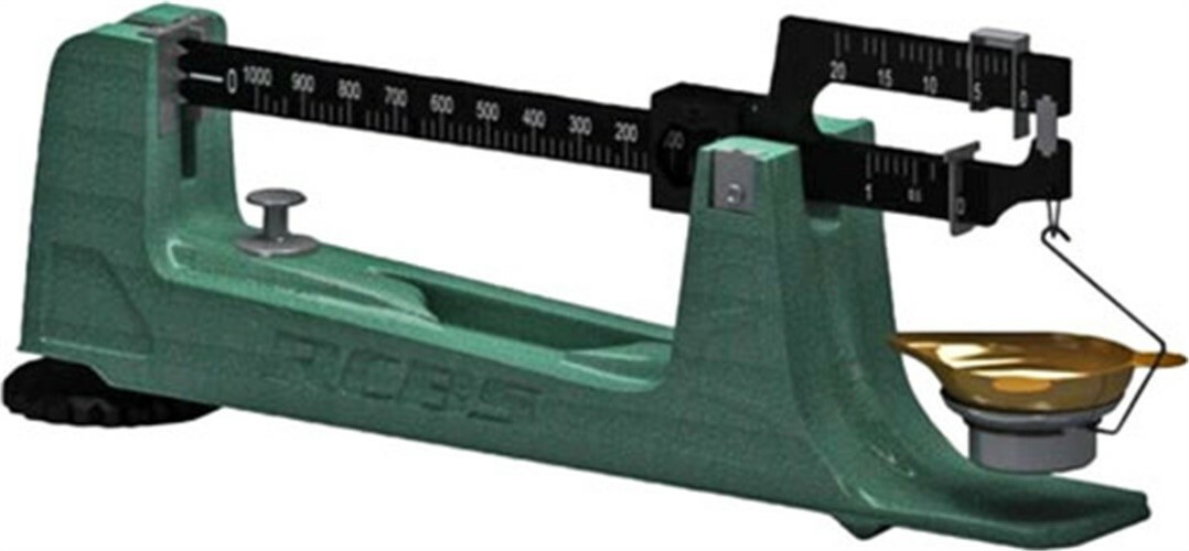

This is where I am at.
If I was replacing the two I have, this would be my Choice; RCBS M1000:
There are a few in Canada; send me a message if you can't find one.
Now I do like that beam scale. I find the Lee tricky to use and maybe thats what caused the problem for me ? this one seems to have very defined needle points. I see X-reload has some.
