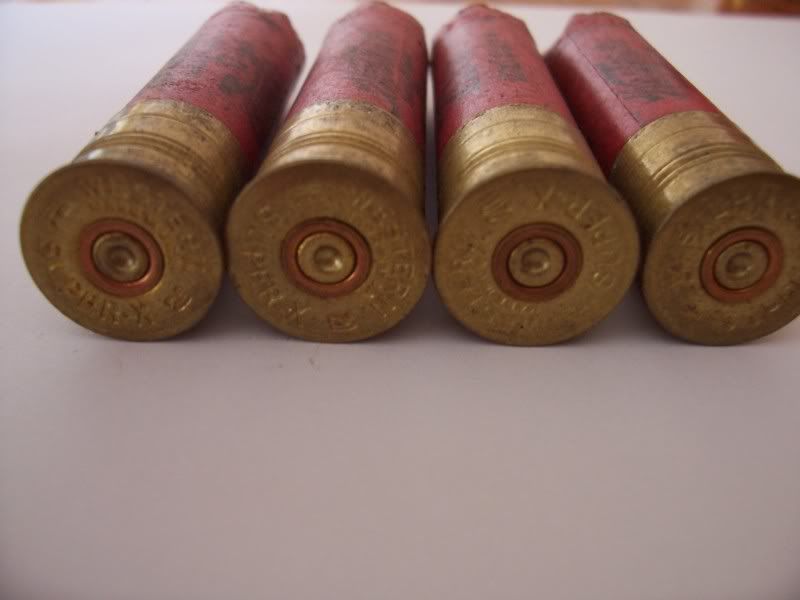

In my 40 plus years of reloading shotgun I have made many a mistake but a double load didnot cause this.Shotgun is nothing like rifle as you know. I have seen quite a few barrels blown over the years at a club and 90% were the end result of a wad staying behind from a previous shot, snow or clay in the end of the barrel or in the real old days dropping a red 20ga in by mistake followed by a 12 ga round. Those explosions normally took a few fingers with them however. I still have some red 20ga hulls I kept as a reminder poor picture however.Bottom line check the barrel all the time between shots.So easy in a O/U
