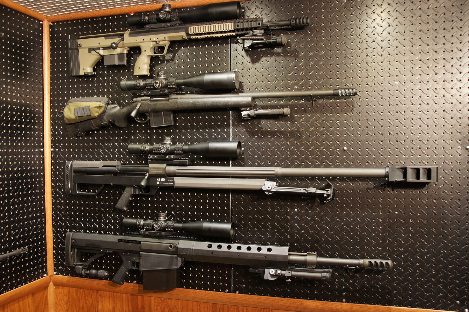

I'll post a bit more on this when I get home from work, but I can strongly recommend the NXS 5.5-22x56 with zerostop.
I had plenty of play in my budget, and I ended up with four of these scopes, one for each of my .338's and .50's.
Built like a tank, glass is very clear, and you can be 100% confident of your adjustments, they are very precise and totally repeatable.
For reticle, I would advise against a bdc reticule, they severely limit your potential to tune the rifle and loads, and never seem to work 100%. Go with an MOA reticule, or Mil if that is what you get your turrets in. Always try to math your reticule with your turrets, forget mil-dots. For NF, I can't say enough about the MOAR reticule, having the ability to count exactly moa to adjust your shot has seriously improved my shooting and my ability to call for others, it is just natural, no math to do. Shot landed 2.25 MOA over on the scope? Dial 2.25 MOA over. Bang, done!
