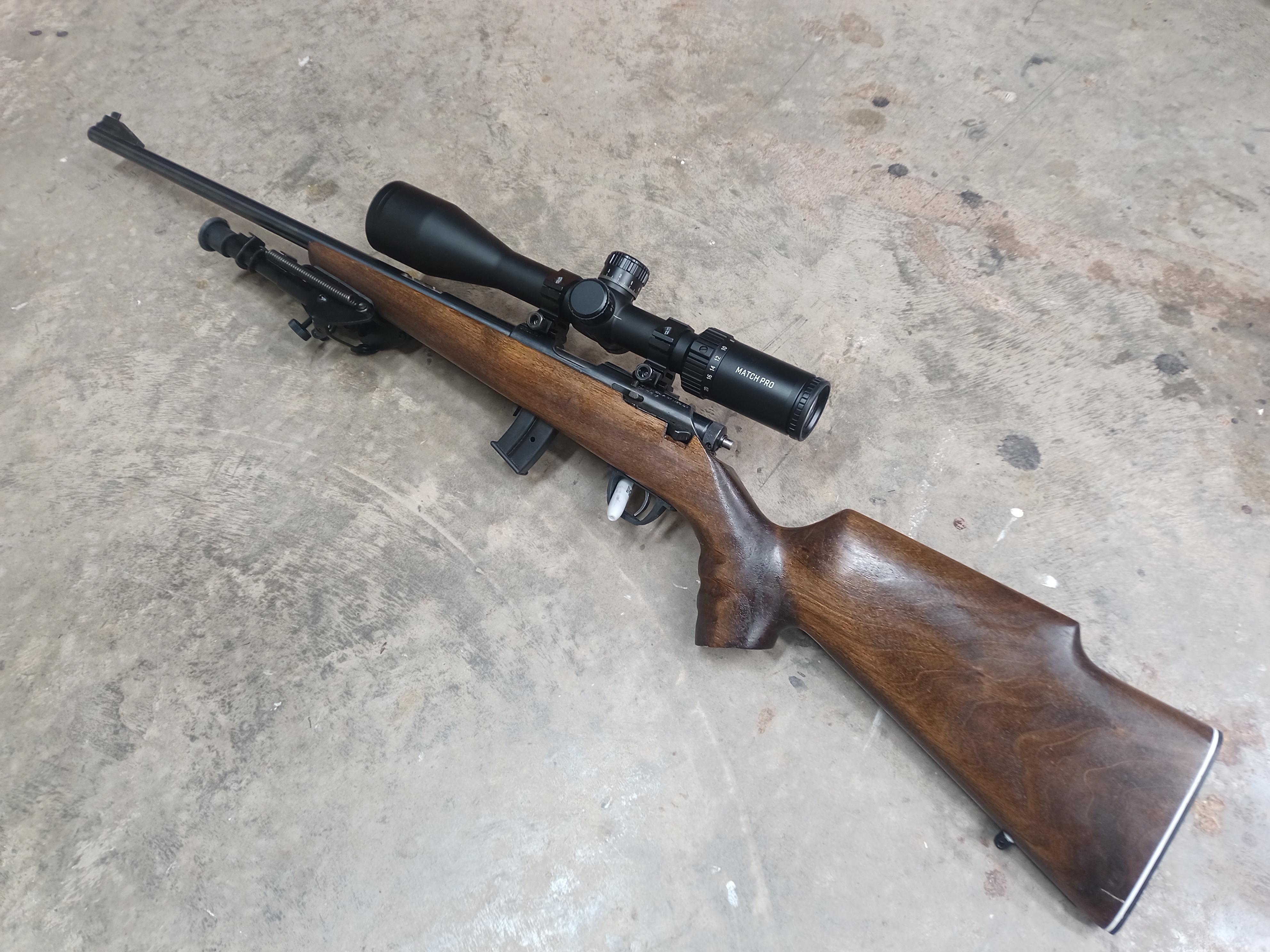

Mine works just fine, factory stock. It's in love with Yellowjackets...
