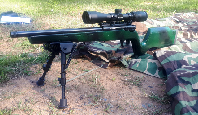

I put a rail and cheek piece riser on my son's rifle, getting ready to shoot some NRL 22 matches this summer. And loaned him the Athlon scope from my 308, so I guess I won't be shooting it for a while. With the rail we'll be able to use the same bipods and stuff, and I'll be able to add some weight at the front to balance it a bit further forward. As it sits, it balances right at the back edge of the rail with the bipod attached.IMG_20250310_204011971.jpg

Looks great... nice paint job. Consider adding front ballast so that it will balance without the bipod. I have a weight that can screw into the front of the forend. You can also pour lead shot into the barrel channel.

Thanks. We've got some chunks of scrap brass 1/2"X2" flat bar at work that I'll make some weights from, hence the longer than needed rail. That's what I did on my rifle as well. Maybe we'll see you at the NRL match coming up in Summerland.
