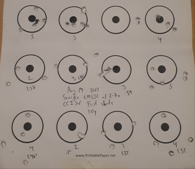

Also shot a few rounds at 50y. Hard to tell if it'll get better with time as I wear in the barrel. I doubt these are cold-hammer forged and perfect out of the box. Best seems to be a 3grp .39"/.78 MOA
(Circles are 1.25" inside with a .34 dot)

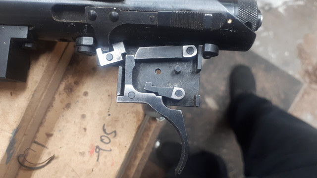

Is this how the 20" trigger is made as well? How do I disassemble to polish and replace the spring? It's all just rivets.
Average was 1.29" including those massive flyers.... take them out and the average is 0.84". I was hoping that lapua XACT would stop having flyers but this lot (old stuff, last stuff at another dealer) obviously was not their best lot.
100yds, light winds, hot/humid. Still looking for a good lot of ammo to get rid of these flyers. But still very impressed with this rifle.

No. It seems to all be rivets. After deer season I'll add a screw to adjust for over travel.
Shot this week's ago but just posting now, for anyone curious. Shot off a front rest and a sand bad rear. First shots of the day at 50y

Looking back on this thread for spring tips, my trigger looks way different then the 2 posted here. My trigger is actually 3pcs...ill attach pics later.
Jerry, how did you remove the front sights?
Made a spring tonight. Pull is now 2.3# down from 3.8#.
See how mine is different? I find it weird that a company would go through the pain of having THREE+ different versions of a trigger assembly.
