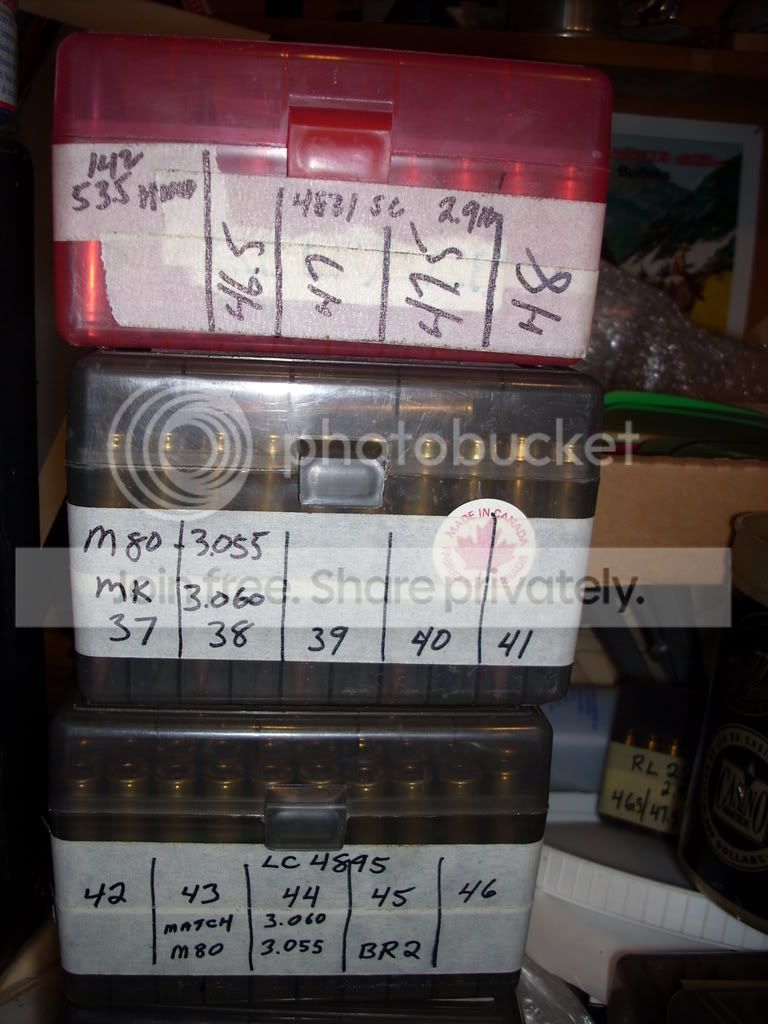

I use masking tape to make labels. I load ammo in rows of 5 or 10 per test. Low tech, but it works.
You can write load data on the bullets or the cases as well with a Sharpie. It's probably the most common marking method I've seen.
Personally I leave paper notes in the plastic cases with a grid marked with what each row (usually a group of 5 rounds) is loaded with. I try to arrange the rows in a pattern with different bullets (HP vs SP for example) so that the grid can't possibly be read upside down.
