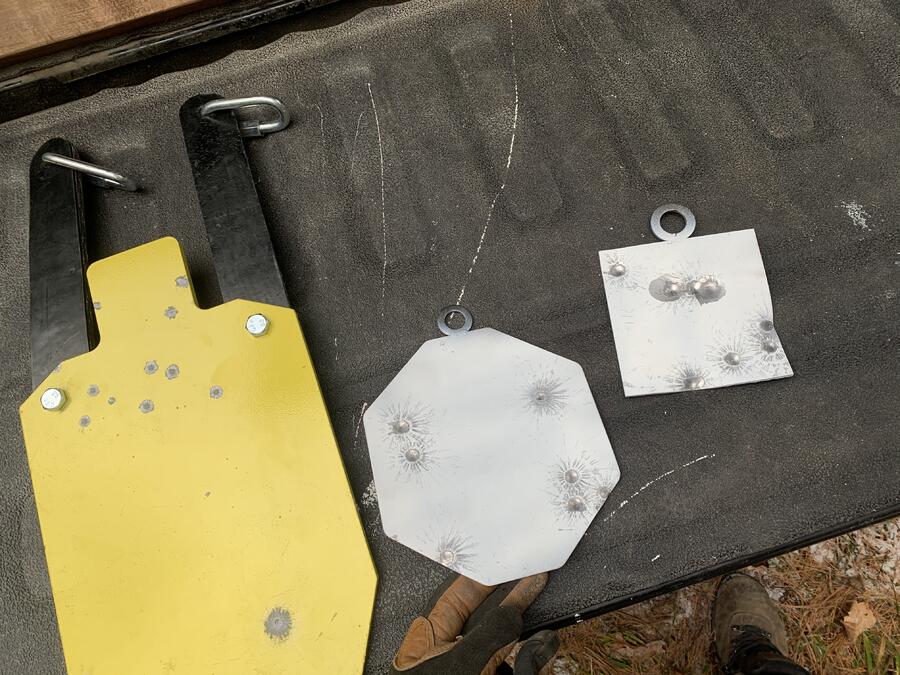

4” Square placed @ 133m
6” Hex placed @ 171m
1/3 IPSC placed @ 267m
All shot off a tank trap in -3 weather with 13km/h wind blowing.
1136 FPS Chrono’d just before attacking steel
457 16” ProVarmint w/Tuna Can
Bottom shot is 223AE for reference on how it affected the target, please ignore

Very Noice shooting. Especially in those conditions.
