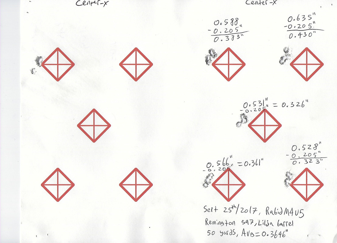

Compared to all the factory barrelled CZ's I've had, yes, absolutely! Laugh2 I ended up with a Lilja barrel from a group buy intended for CZ's where they messed up and cut the cone breech lip too thin and the chamber was splitting. Being in Canada, I couldn't send the barrel back to them for re-work, so I ended up with a free barrel from them that went on my custom CZ and did the 1/4" challenge. I got to keep the defective barrel, and got to thinking... what if I have it fitted to my Remington 597? Why not, right? What's the worst that can happen... :d. I'll let the results speak for themselves.
That’s some mighty fine shooting RabidM4U5. Quality barrel with assembly by a competently skilled person results in an accurate firearm. Well done and thanks for the pics. Cheers Chris
