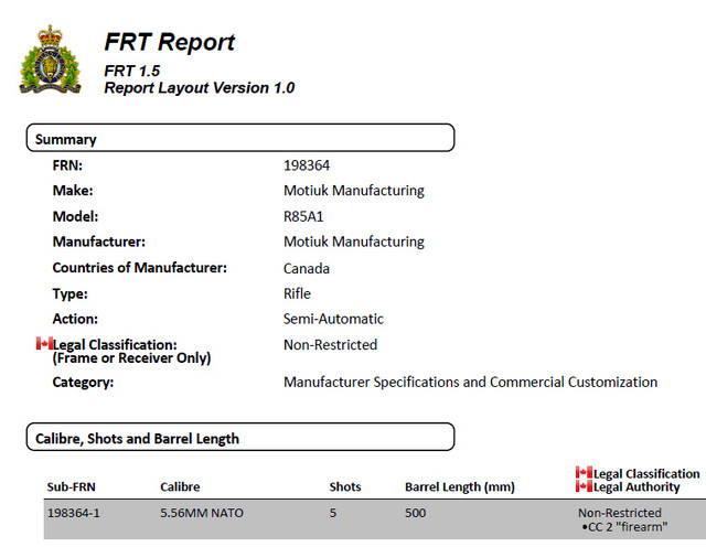

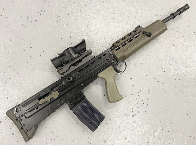

Sending this off to the RCMP SFSS today. Hopefully it comes back as NR in a couple of years haha.
Awesome build, hopefully it comes back as NR! Did you use a WK180 for the internals? What parts did you have to manufacture vs had on hand (other than the receiver of course)

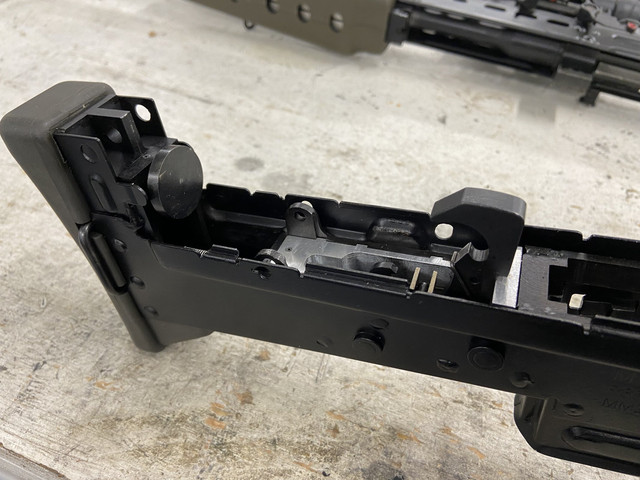

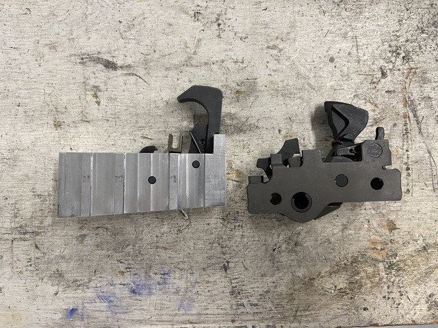

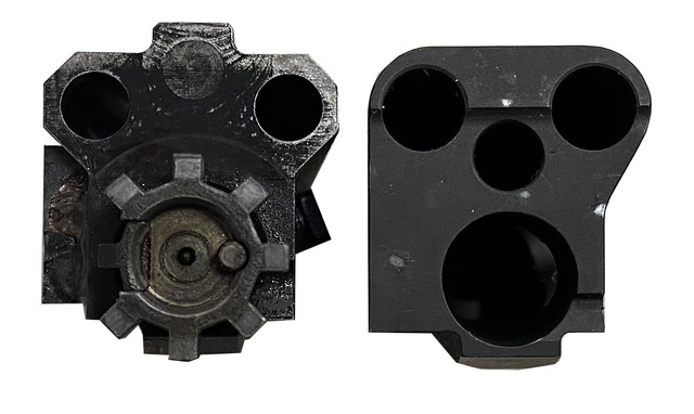

Here's a few pics of the inside. I used a modified a WK-180 BCG, modified AR-15 trigger group, modified BRN-180 gas system, and a bunch of newly machined parts like the trunnion, rear support, trigger group housings, front support, gas block, etc.
Lower / trigger group
Upper
Semi-auto bolt carrier vs. Full auto bolt carrier
Semi-auto trigger group vs. the Full auto trigger group
When you say, "sent this off" does that mean you had to send them the actual rifle?
Yes often manufacturers are forced to send a sample to the RCMP lab to be deemed safe for sale as it cannot be "easily and readily converted to full auto" according to bureaucrats, likely not technicians.
if it is a manual action firearm it is much less likely of a requirement. Some bolt actions and pump actions for example get approved relatively fast compared to semis
