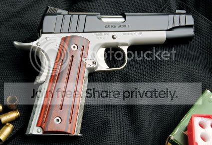

well the verdict is in...I went to the 3 local shops today...3 hours of driving and i have purchased a handgun. First store had nothing.....second store had the entire cz line up and a few 1911 in 9mm, last store....good ol reliable gun..showed me all the shadows and low end 9mm 1911 the he pulled a kimber out needless to say i now have one and I blew my budget right to hell with this purchase but I plan on keeping it forever...I have never felt a gun that felt so right in my hand...
Kimber Custom aegis II
o lordy im in it now.
Kimber makes nice stuff. You may have blown your budget but now you've got a great foundation upon which to build a great collection.
What caliber is it? I see .45 casings in the picture but that doesn't mean much since there may be other chamberings offered.
Also now that you've got a center fire your next mission will be to find a nice .22 to help you kick your inevitable flinching issue that you'll get just like the rest of us.... :D
