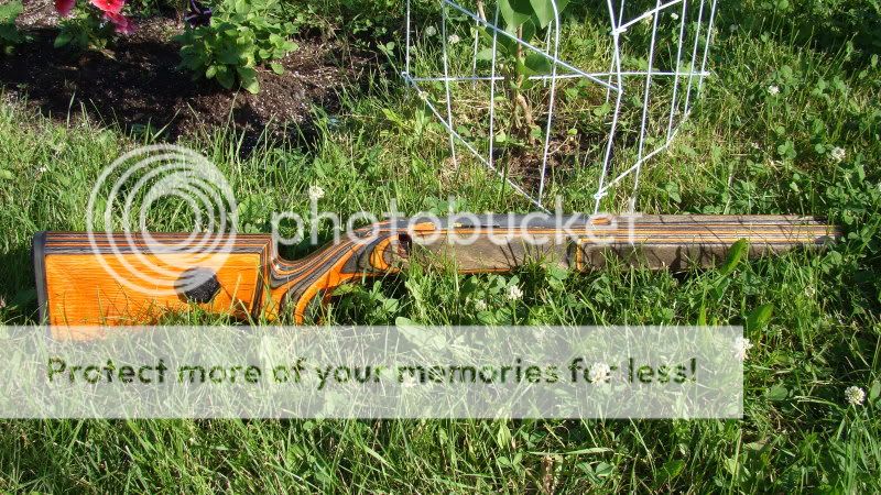

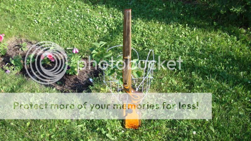

This is the stock right outta the box.
Next thing to my surprise was the inletting was 100% perfect. No kidding. There was no need for breaking out the dremil to do any fitting for the action or barrel at all. I give SSS a big hand for a A+++ job on the quality of there work.

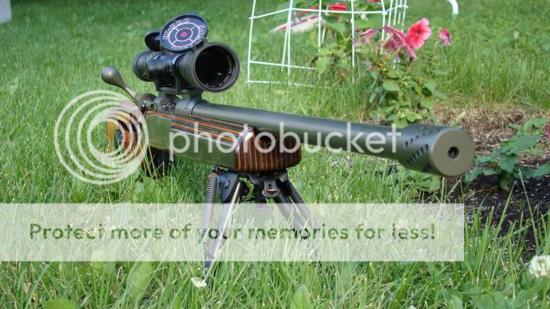

I finished the rifle with Truoil and Birchwood/Casey stock wax. It is a very meticulous process to get this right. I did a lot of coats before I found the best thing to do is a few heavy coats with 0000 wool buff job between coats. After a few heavy coats are hard a color sand job is necessary and then do a couple extremely light coats, just enough to shine it up again. Its not perfect, but sure is shiny.
Overall this is the nicest laminate stock that I have worked with and well worth the extra loonies. Hopefully for those considering this stock your lead time will be shorter than mine.

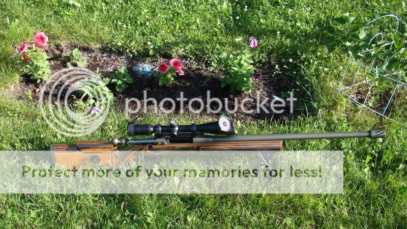

Here is a pic of some shooting I did a couple weeks back. Twas a good day.

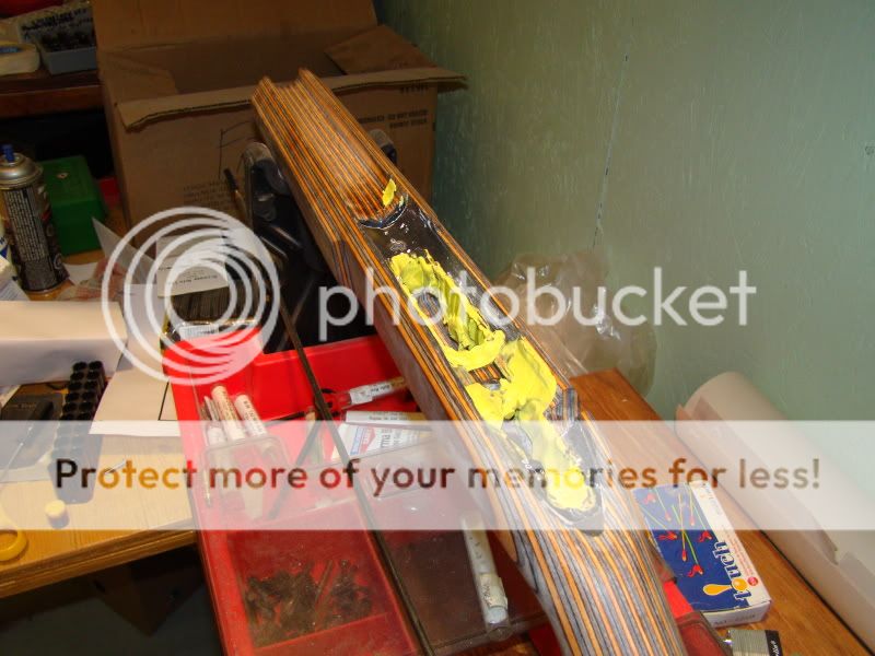

I have had this stock for a bit now. I bedded it right off the bat. It came standard with dual aluminum pillars.

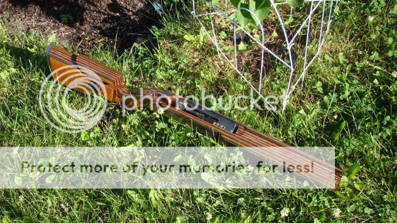

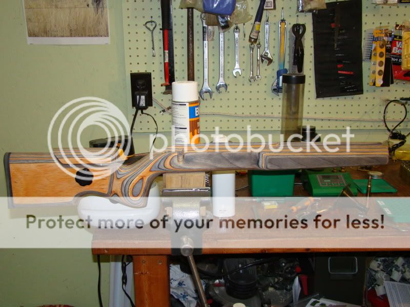

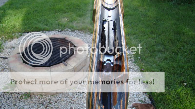

I have to say for an unfinished stock this required next to no finishing other than the finish itself.
