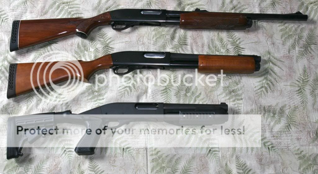

Bottom one is a 12" Dlask. Middle is a 14" Remington barrel. I prefer the 14", and most of the dealers are taking orders for genuine 14" Remington barrels right now.
I'm not totally sure that those work in a supermag, someone confirm?
I got off the phone with remington a short while ago and apparently yes they are compatible as long as the barrel is not a "tactical" barrel, because then they will only work with Remington's "tactical" shotguns. It's somewhat ambiguous, but as long as it does not have a "tactical" designation in the name, it should work.
First of all thanks a ton for posting a picture, that's very helpful.
I was looking at the 12 inch Dominion Arms barrel, from Canada Ammo, mainly because of the price. Do you think there's a huge difference between the DA barrel versus the Dlask 12 inch barrel aside from price?
Also may I ask why you prefer the 14 inch barrel? It looks like you have a 1 shot extension on there, is that the case?

14" just seems to feel better, and looks good with the plus one. Also, I have had it with aftermarket barrels. I have had 2 DA barrels and both of them had the barrel ring indexed enough that the bead was a couple of degrees off center. You can get genuine Remington 14" barrels for $155 or so, that is what I would go with (I actually have 2 of them on order). To be honest, nowadays I find I am swinging back to the 18" more often. Extra length means longer sight radius which means better accuracy. Also the shorter barrels tend to shoot high unless they have a taller bead or blade up front. The dlask does and the DA doesn't. I had an 8.5 DA, and if you put a straight edge along the top of the receiver, the front bead was well below the receiver which means to line up the bead you have to raise the front end which means you shoot high. The 12 is actually gone from my collection, and I currently have 3 with 18" barrels and 3 with 14's, and a custom 8.5 for the gong show at the action range (birdshot at 7 yds)
