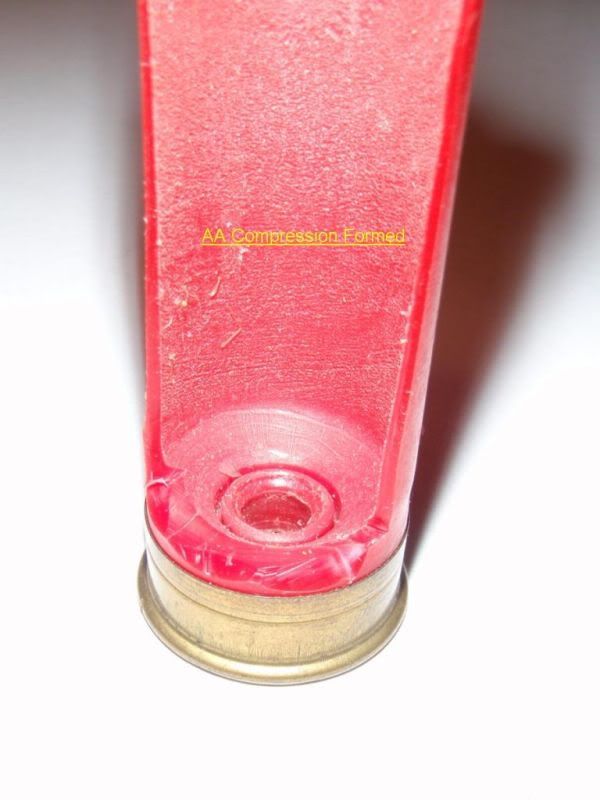

Here is the old aa. Compression formed one piece with tapered walls
In the center is the new AA hs, Straight walled two piece hull with seperate base wad. Apples and oranges from my limited experience with them.

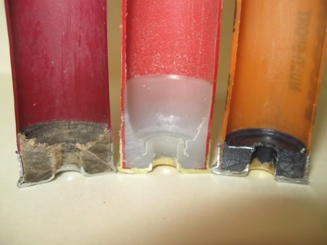

Kind of nice photos 3macs1...
Kind of nice photos 3macs1...[/QUOTE]
Cannot take credit for these Fred. I saved these pics and many others of cut hulls from a post a few years back on another site.

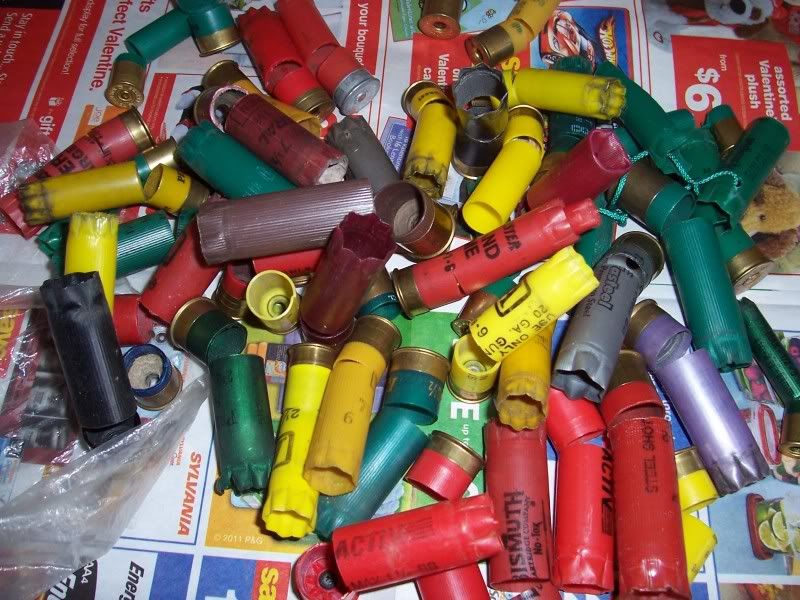

Covey don't cut your fingers. I kept one of every hull produced from 410 -10ga cut in half for reloading reference right from the late 60's until about 5 years ago.Guess I am going to have up see what trash has been made since then to get my bag up to date.
So if there is something you want to see the inside of I probally have it.
Those three are a winchester universal, a win comp formed aa and a win e pert target. I have some win HS just have not split one and put it in the bag.
That last pic should take you back. Remember shooting the black trap AA's or paper federal champions. I bet you do.

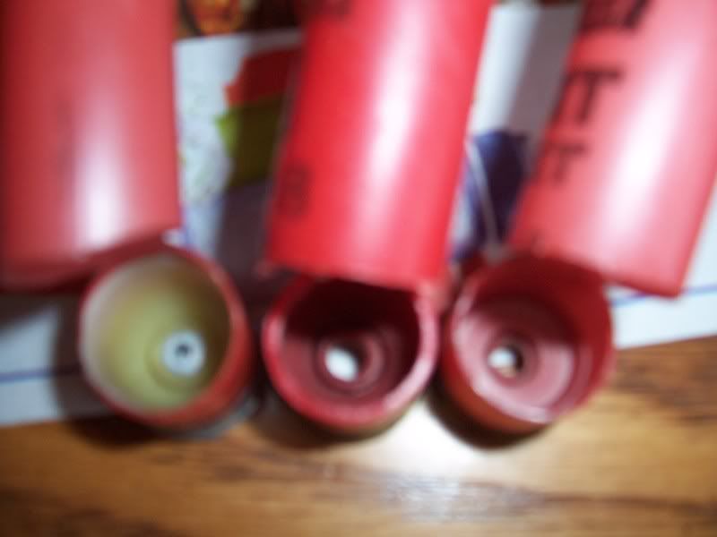

Excellent info guys thanks for the pics .after haveing a closer look at the new batch I got from the EE I see they do have a seperate base wad .i will cut one and post a pic also as they look to be different again from what has already been posted.well after cutting it open I see the only difference is the the base wad is made of red plastic rather than white.had a close look at the way its constructed and the only way I can see the base wad coming loose would be with repeated fireings and not resizeing the base.the primer pocket and the out side of the base seem to lock the parts together very well.
