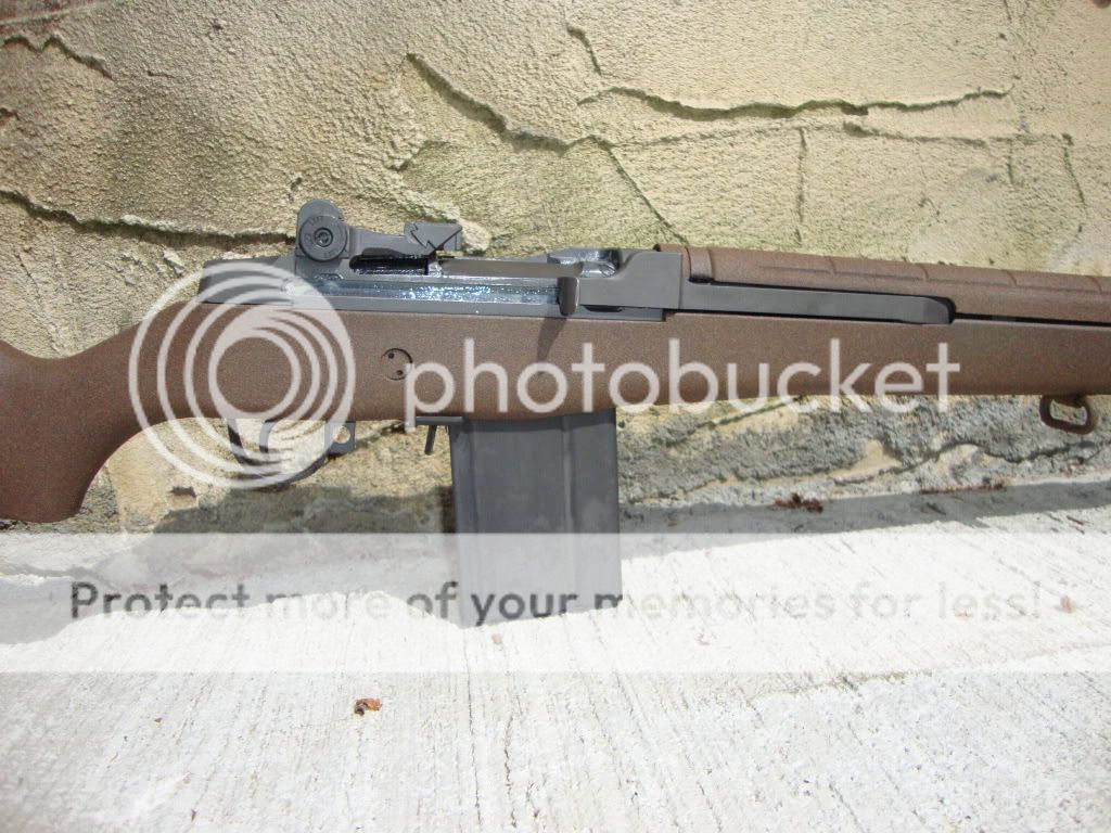

I gotta say that looks quite nice ... I'm not one for synthetic stocks lately as i'm loving the wood feel/look ... but that's sharp with matching handguard!

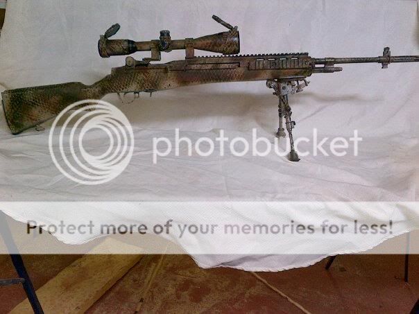

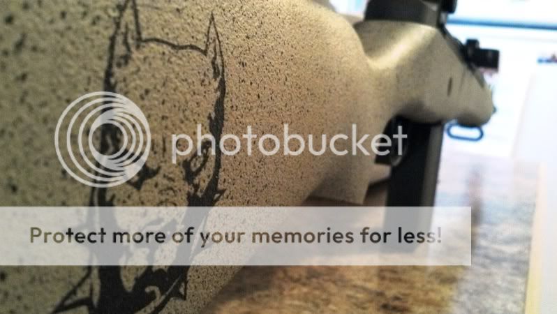

Yes ...... Krylon Fusion its ment for plastics ...we have used the
no-textrued at work an it bonds like crazy doesnt rub or chip off very durable ...this is the first try with texture ...and was like 12bucks ...so if it dont work ...oh well
Looks good for 12 bucks. After seeing your I was set on a textured stock, just took a slightly different direction.

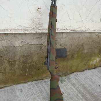

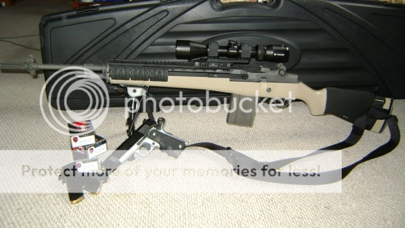

Here is bed liner on a custom USGI stock:
That looks pretty sharp.

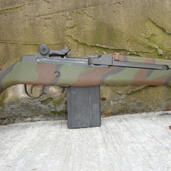

I've done a few mods to the chicom stocks now. I use 80 grit sandpaper on a mouse sander, then hit with adhesion promoter spray, then 2 coats EZ Liner. Let it cure 72 hours then either krylon paint it or dull it down with Rona matte clear laquer ;)
