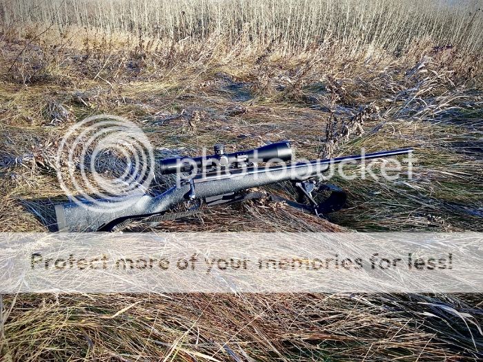

Yes, you are correct.
Tikka T3 Varmint 6.5x55
McMillan A5
Sightron 8-32x56
CDI Bottom Metal
Armacoated Barrelled Action
EGW Rings
Ken Farrell 20 MOA Rail
Vektor Brake
your stock looks incredible; what color selection did you order to get that look/pattern?
Also, I didn't see a long action CDI kit for the T3 in a standard caliber; what did you use and did you have to mod anything?
Thanks
Kosmic I know you have heard it a lot but I also think your rifle looks awesome. I have the same scope and stock on mine. Let me know if you ever want to sell it!

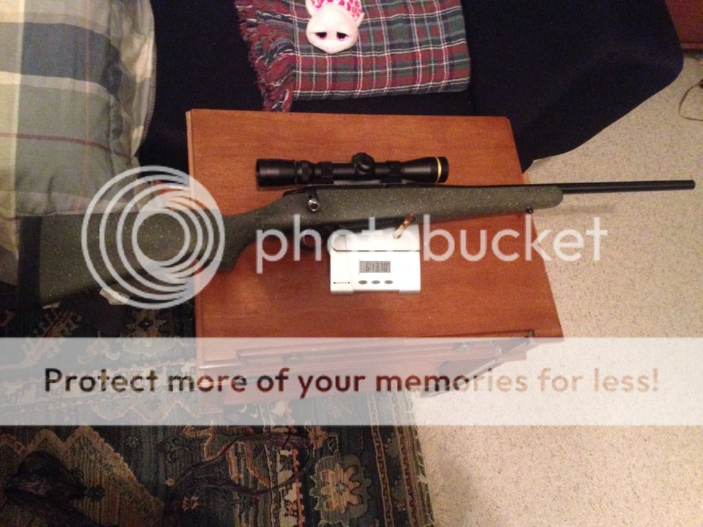

I put this together with a new Tikka T3 Compact in 308(20" barrel), picked up a new McMillan Hunters Edge stock on the EE and a Leupold VX-3. It weighs 6 3/4lbs with one in the chamber and a full mag.
This is super nice! I have been wanting to put together a hunting rifle like this for a while. Thanks for sharing!

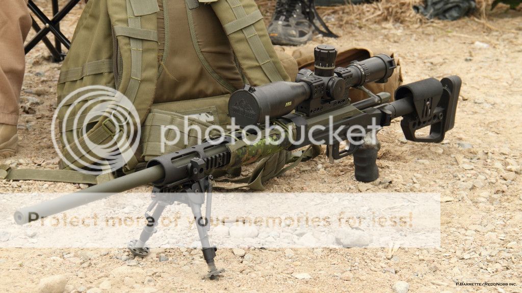

Here is my take on the Tikka
T3 receiver
JC custom barrel
Aluminum bolt shroud
Chambered in 6.5 x47 Lapua
XLR stock
Spuhr mount
Mountain Tactical 20 MOA picatinny rail
Bushnell XRS optic
Yo Dave trigger upgrade
Barreled action cerakoted OD green
