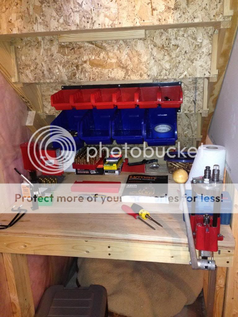

Just recently moved into a new house where we have a bit more room. I now have a small basement "office" where I was able to build a new reloading bench with a bit more room. My old bench was just 2'x4' with only one shelf underneath. The new one is 30" x 6 feet, with one lower shelf and 2 upper shelves. It will need some organizing because I just started unpacking moving boxes and filled it up as I emptied boxes. The legs are all 4x4 posts with the rear 2 legs carrying up to support the back/top shelves. There is a frame and 3 additional cross pieces of 2x4's that support a 1.5" thick solid wood top. The top I scavenged from the local transfer station woodpile a few weeks ago when I noticed someone had thrown away an old 10' long solid wood desk. The legs were missing and the drawers were mostly busted off, but I was able to repurpose the top into my new bench. All in all, I'm into this project for $70 worth of lumber
