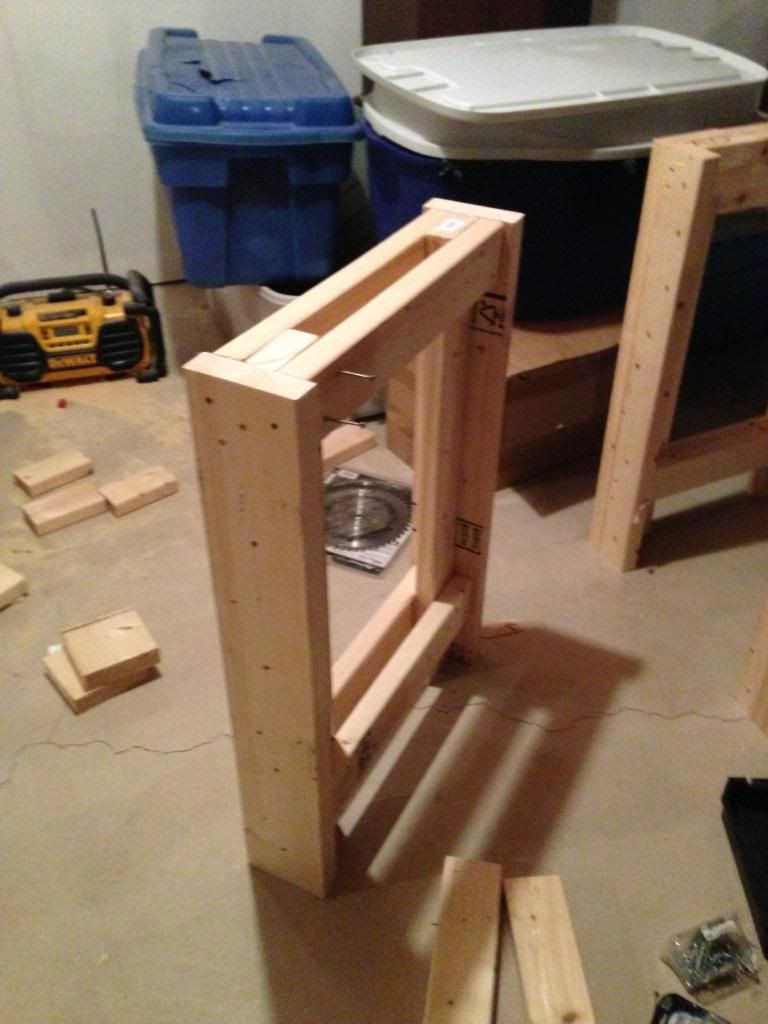

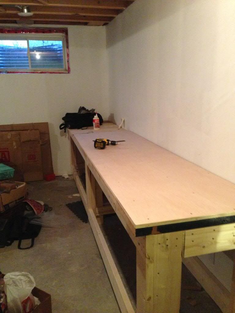

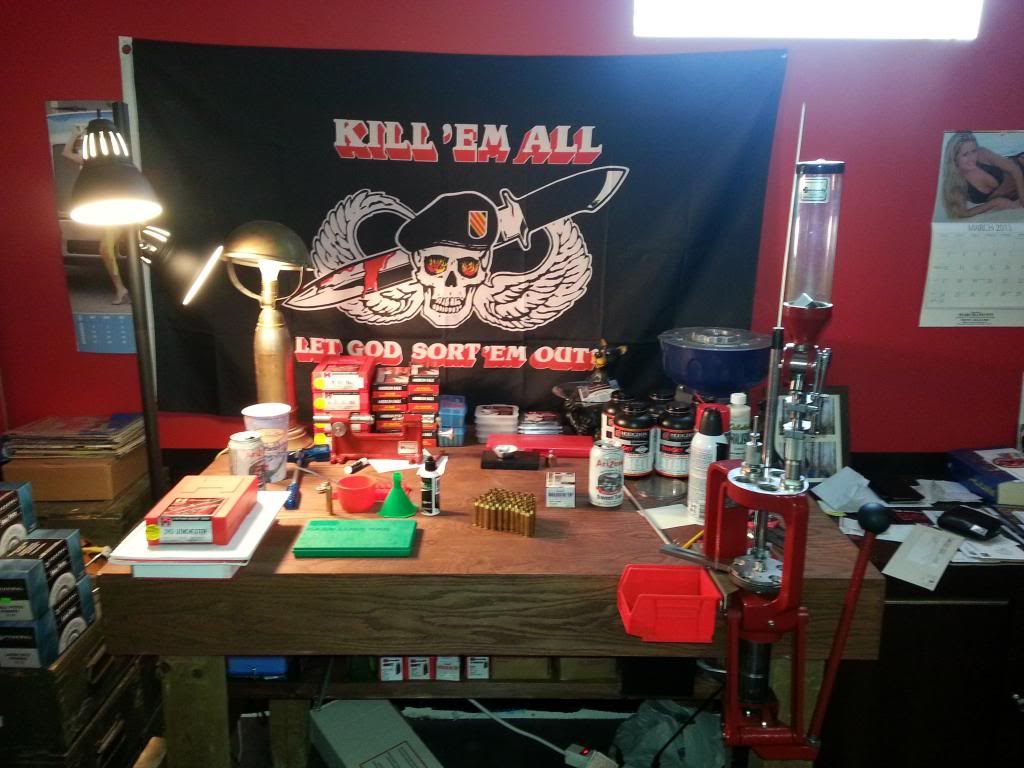

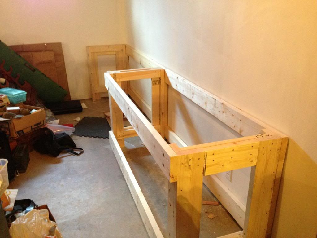

Here's my new set up so far. The man cave is in progress, it will be my gun room/office. Kicked around a bunch of bench designs before going with this. 2x4 and 2x6 construction, everything is glued and screwed, and carriage bolts on all corners, and built it to the wall studs. I was sick of losing energy through deflection on the old bench, so I think i solved it with this one. 12' long, 36" high, 28" wide, with a 2.25" thick top. Tools will be mounted to wooden mounts for easy locating, still haven't figured it I will just clamp them or drill some universal mounting holes.

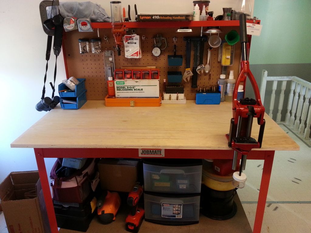

I havent replaced the shelves on my bench yet, I didnt like what was there (I am no carpenter), and have yet to decide (design) what will work better. Thanks to many of these posts I now have an idea.
I would also like to build a dedicated book shelf, and turn the closet into a lighted gun cabinet. I have ran out of room for rifles in the house...lol

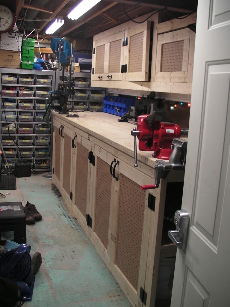

Been modified and cluttered and uncluttered dozens of times now, got a nice cycle going here.
From when it was first built...

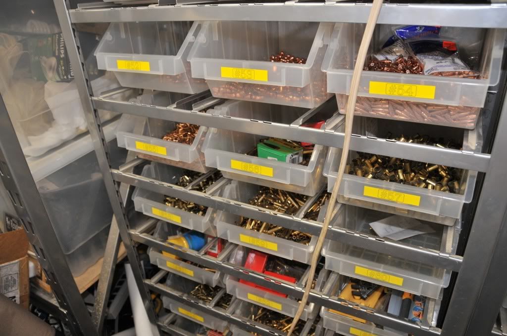

Component storage in bins close by...
Sort of filled up. Looks similar to this now, except the 1919 and other guns are in the gun display room now.
Visually cluttered but very functional as long as I keep it clean.
