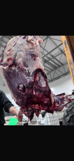

That’s a 140 grain game king out of a 6.5cm on a decent size whitetail doe
I've used 140 gn in 6.5 swede and 6.5 Creedmoor to hunt whitetails. They have always been more than adequate - in one side out the other. The only time they didn't exit was when I put it through both shoulder blades at about 50 yards - then I found it under the hide on the off side.
If you keep MV under 2900 and aren't expecting it to go through a moose lengthwise, I think you will be ok - they are conventional bullets after all
