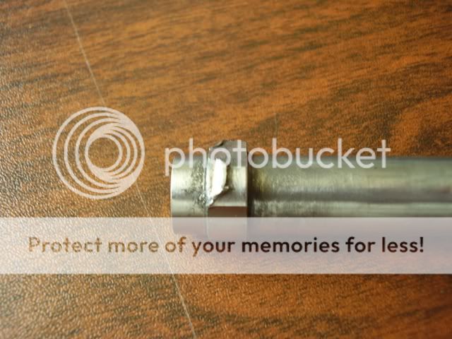

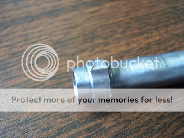

That's a broken 552 bolt carrier. The roll pin has been removed and the piston has been rotated to show the damage to the mating shoulder
this is the bolt carrier mating shoulder from that same piston close up.

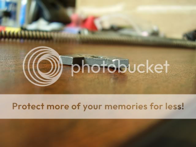

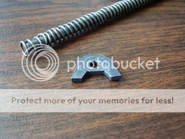

This is the broken Recoil spring guide out of another weapon.
You can see how much of a beating it's taken in this shot.
This is the bolt carrier mating shoulder out of the same weapon that the broken spring guide came out of. It's obviously not as bad as the first one, but it's still taken a hell of a beating.
