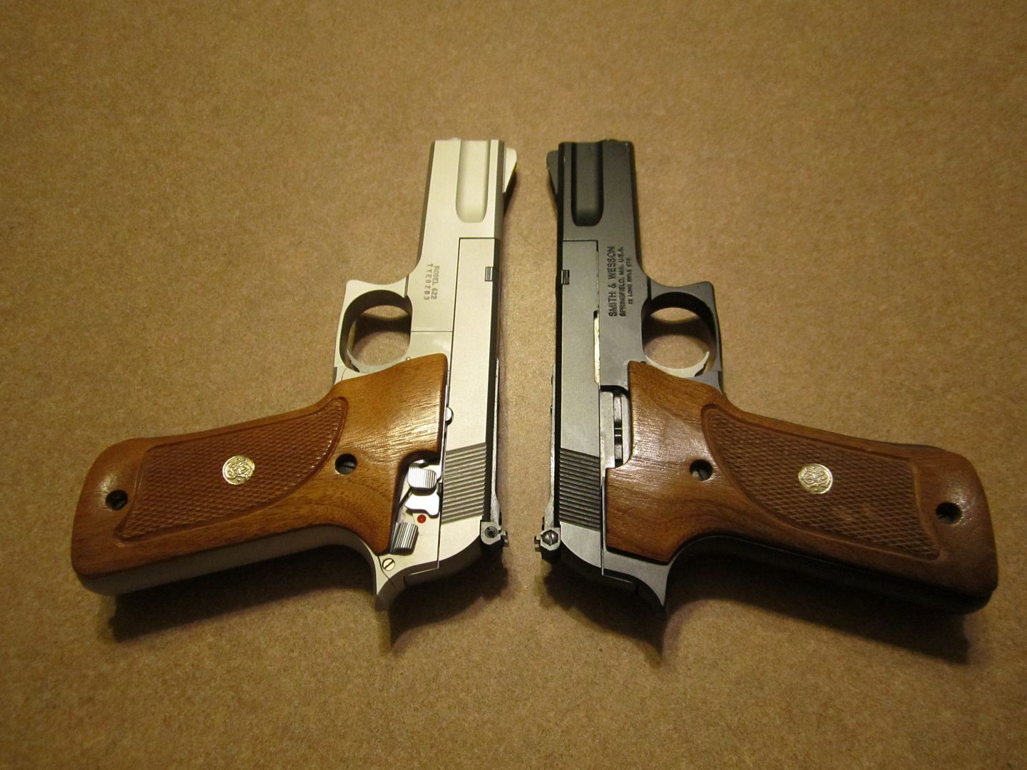

here is a pic of my 422 and my 622, are your rear sites different than these ones?
if so can you post a pic of them?
i didnt know there was a non adjustable version of the 422/622
i just went and looked online and saw a few of the ones i think your talking about.
looks like they are just dovetailed in there, yes?
if so i also saw some S&W model 41 looking sites on them.
maybe look and see if those are the same, they might be what your looking for.

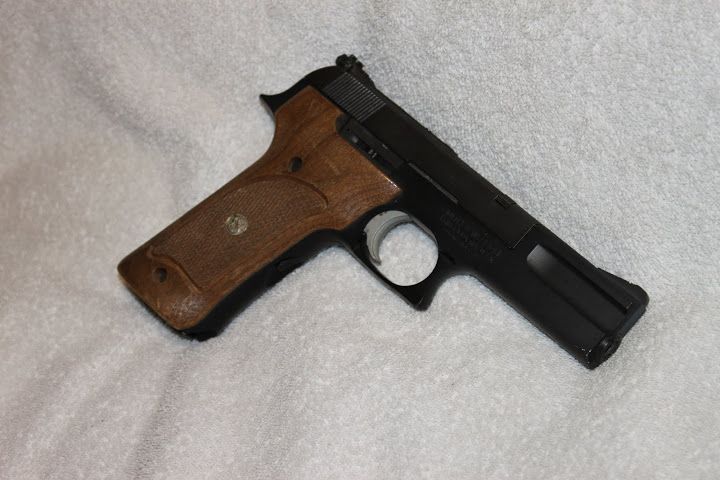

see if i can steal a pic from google here for ya.
the stock adjustable sights
the non adjustable stock sights
the model 41 adj sights that look to fit into the same dovetail
The M41 dovetail looks wider, not sure it would fit in the 622 dovetail. The 622 aftermarket sights I've found online didn't mention interchangeability with M41.
