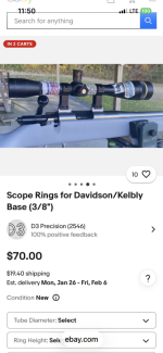

Sounds like he’s looking for Davidson/kelbly style rings. 3/8” 11mm. Your not going to find what you want on the shelf of a Canadian retailer
Happy hunting

Yes it is the Davidson/kelby type that I was looking for and unable to find. So what I found at the nordic marksman is
a set of, Anschutz 18mm sight risers, those with a set of talley low rings will get me to approx 1.35'' which "I think" will put
me where I want to be, given my highly technical way of measuring scope height, tape small blocks of wood to top of dovetail then
tape scope on top of that until I get what feels like the right height. At least if the low scope rings are not tall enough I can return them
to bass pro shop and try the med. Thanks again to everyone for your help. If anyone has a suggestion for a good middle of the
road cost scope for silhouete please let me know. oh... and how to enable email notifications.
