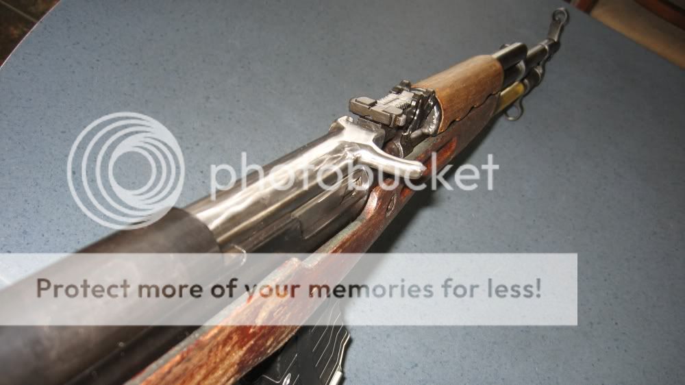

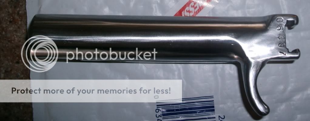

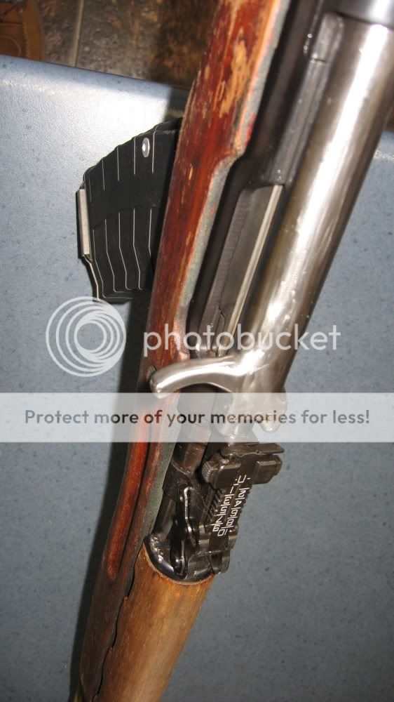

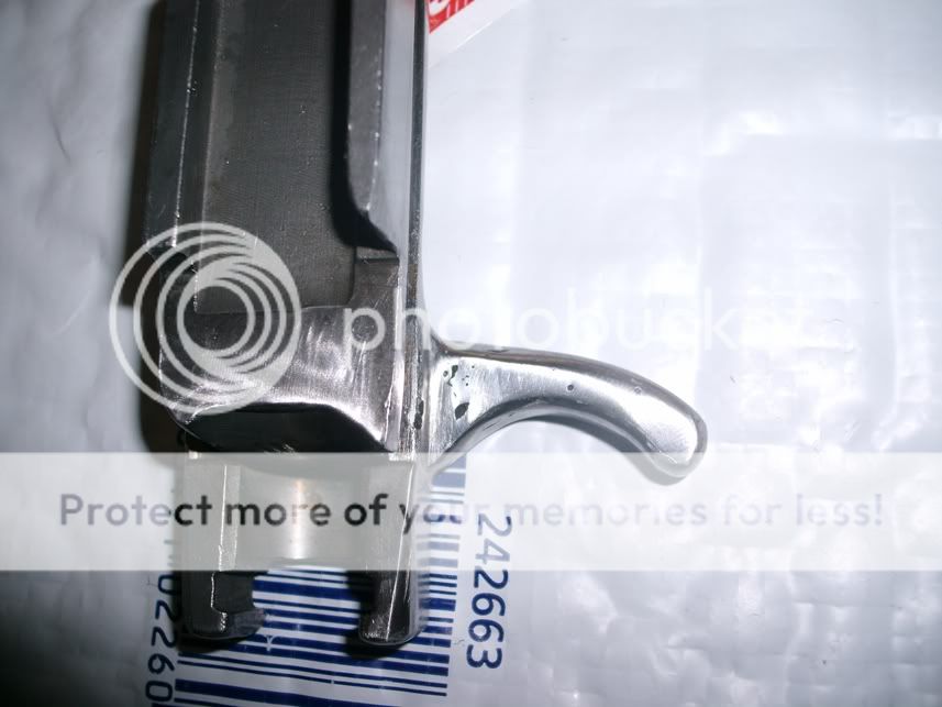

I must say, looking at the job they did I would hesitate to purchase one of their products.
On the underside of the charging handle someone didn't put in enough weld/material to be able clean it up nicely, so now it's all patchy. Gross. Someone there said... oh that's good enough...
I realize it's on the underside of the charging handle but for someone like me with OCD it would drive me nuts.
It also looke like they had to grind the impingement face and clean that up. Makes me think they did the weld with flux-cored wire instead of a gas method like TIG or MIG. If you look at the before pic, the lines are much crisper. The after pics make the underside surfaces look less crisp, almost the melted look.
The guy who did the work is no machinist or welder - I guarantee it.
It's probably functional though, if not elegantly executed.
Again though, I'm not sure why anyone would bother? It doesn;t improve operation one bit, does it?
There was a lot of filling to do on that handle, and I was pretty surprised to find that the metal was a quite porous as well, which led to a lot of small pin holes to fill.
It was a PITA to do... the shaping was easy, but the filling and grinding to blend lines was pretty tedious. My TIG was down which left me with filling with 3/16 sticks.. not ideal at all. Like Claven2 said.. I'm no machinist, just try to do the best with the tools at hand. Since I've never done a handle mod to a SKS this one was done pro-bono from the start.
In the end as long as the customer is happy I'm happy. I'd gladly take it back in the shop once the TIG is replaced to clean it up though.
MIG will fill those pits just fine. I would pre-heat the handle with a torch first though, cold welding with a MIG will add too much material and make your filing job that much more difficult.
I would avoid flux-core wire for that job though, it will spatter and leave dross all over the place.
