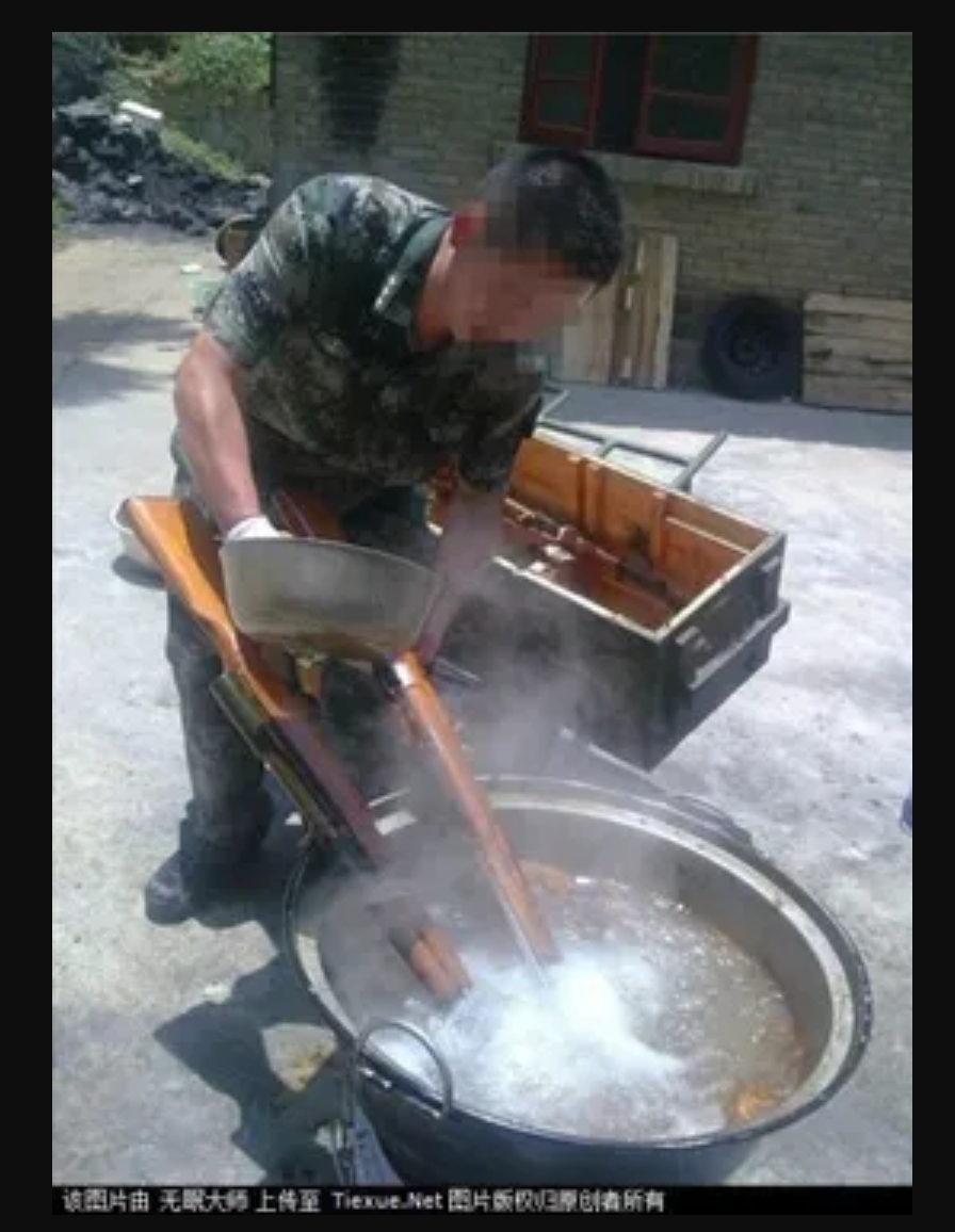

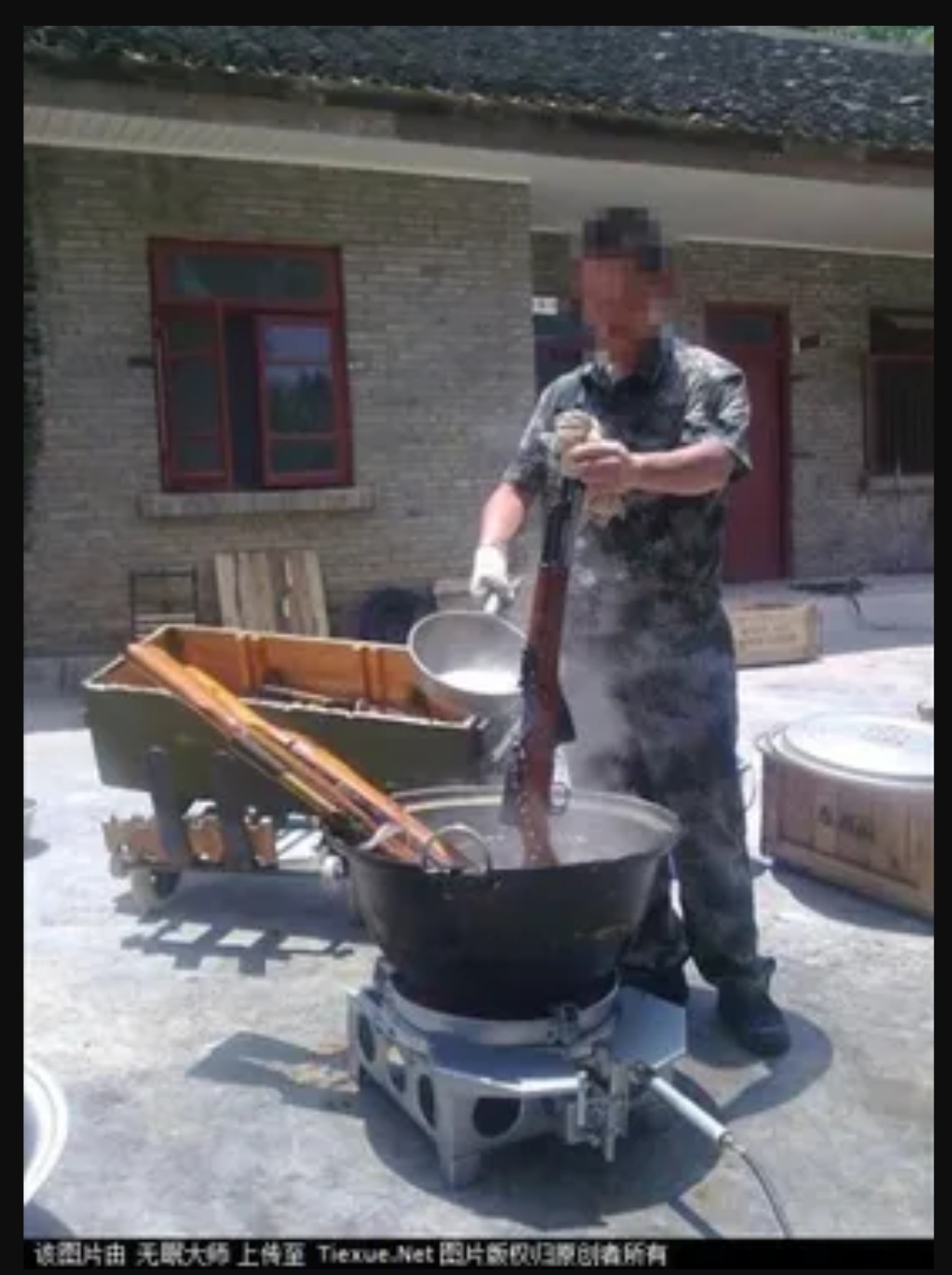

Boiling hot water from the kettle will melt cosmoline, soak in varsol will remove the rest.
Ya I’ve been noticing a few online have said they soaked in boiling hot water to help soften the grease/oil up and then used either mineral spirits or any metal safe degreaser to clean the remaining.
I used Varsol Outdoors with a stiff paint brush over a pan for disposal. The Varsol will dissolve the Cosmo Easily, and the brush gets into the tiny spaces. I completely dis-assembled the gun and brushed the innerds. And the Bayo keeps some Cosmo inside the spring housing. The stock just wiped down w/o any probs, too.
Buy a big stock pot from the thrift store for a couple bucks. Completely strip and any metal parts can go in the pot with boiling water. The cosmoline will literally melt off and float to the surface. Wooden parts should not be boiled
