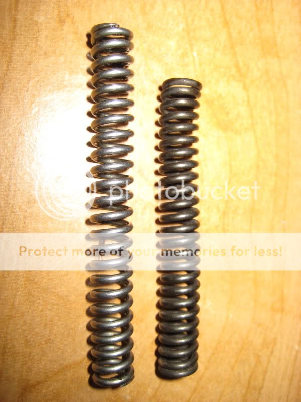

Well I got the firing problem fixed....BIG THANKS to Curtton.
It ended up being the hammer spring was short... don't ask how that got that way, i have no idea. I put the spring in and went to the range, it shot all 20 rounds no problem. So happy i got this problem fixed.
Here is a picture to show the difference from old to new spring..
Good detective work!
The old spring got tired/fatigued, that's why it is almost bottomed out.
Either from a lot of shots (dry or live) fired, or possibly poor spring steel.
Turned out to be a simple and cheap fix. Thank you for sharing and to those who helped in the solution. We know what to look for when the same problem happens to us.
