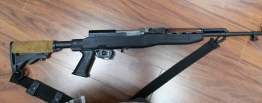

BTW - here's my TAPCO stock, adjustable length of pull. The fit is very snug, so No need for 'shims'. And the suede keeps the cheek-pad 'softer'. 😉

It may be cost prohibitive to change stocks, modify triggers, add a rail and on optic these days. However, what I paid for the mods then, would now work out to a few hundred dollars less than what I could get for it in todays market.
Contrary to your opinion it is a shooter. I have no reservations using it as 150 yard deer rifle.
