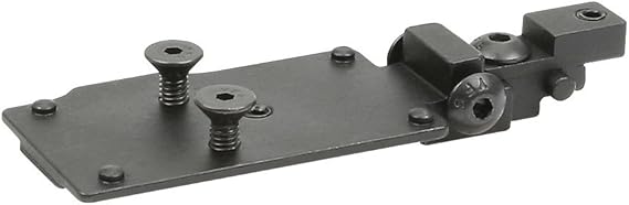

I’m a little curious but bypassing the iron sights in general has anyone used or tried this mounting system Searched the thread didn’t find anything maybe I missed it the Midwest industry’s mini red dot mount.
That mount was discontinued a few year's ago now.
NcStar has discontinued the one SKS mount they made which mightn't have been completely awful. The low-profile receiver cover mount with the rail which sat flat on top, often sold along with the NcStar micro red dot reflex sight, is no longer being manufactured. I need to scramble to pick one up while I still can.
