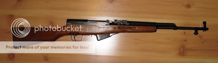

Basic Chinese SKS with ventilated upper handguard:

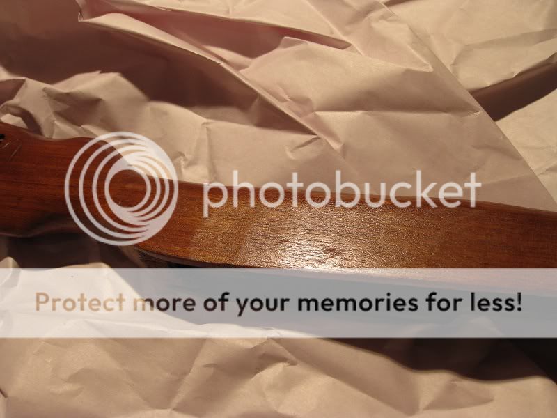

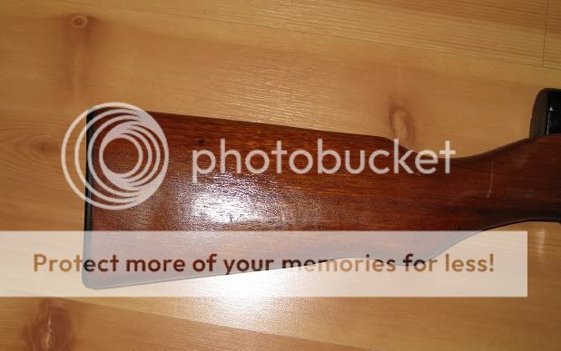

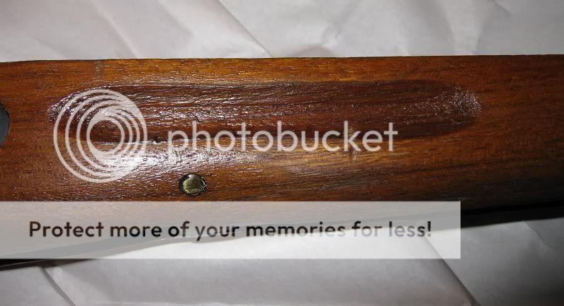

Uneven finish (shiny and dull spots, also highlighting uneven wood):
Another example of uneven wood:

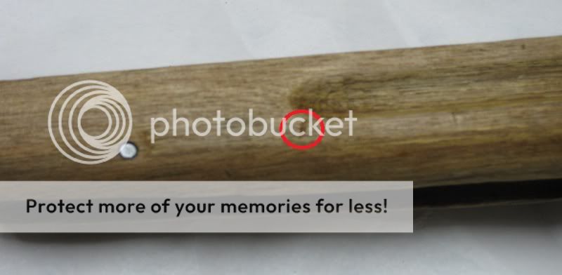

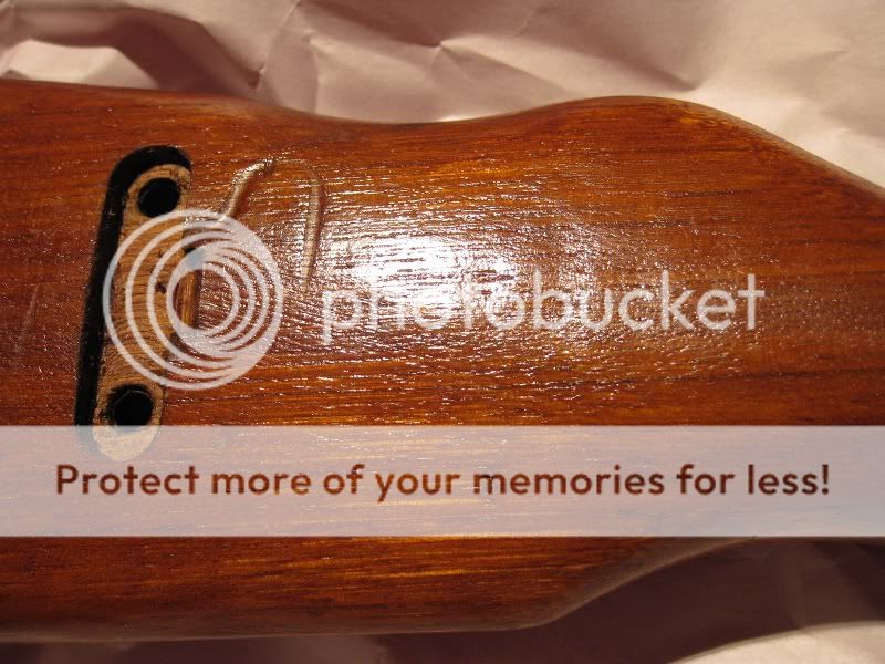

Sample dent:

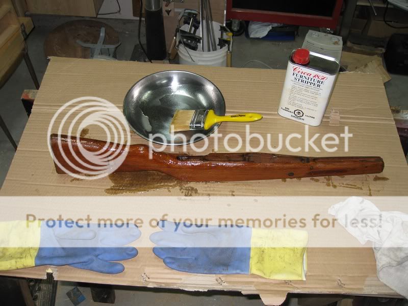

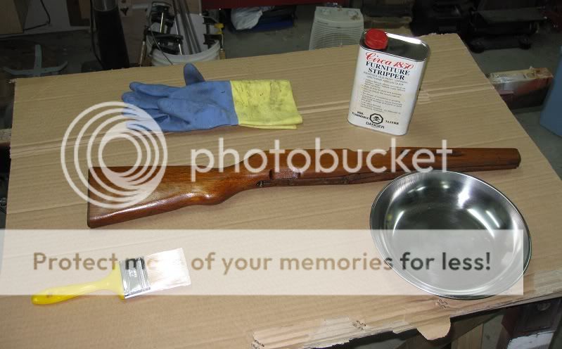

Got a little time tonight to strip the old finish. Real easy job. I bought the Circa 1850 Furniture Stripper from Home Depot and followed the instructions. It's nice to have a product work as easily as the container says it will. :)
Getting ready:
Slapped on a generous coating and let it sit for about 10 mins:

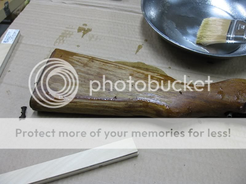

The camera flash exaggerates the orange in the finish so the following shots are without the flash and using a tripod. Colour is much more accurate now. Here I'm starting to scrape off the old finish with a scrap of wood. It just falls off the stock.

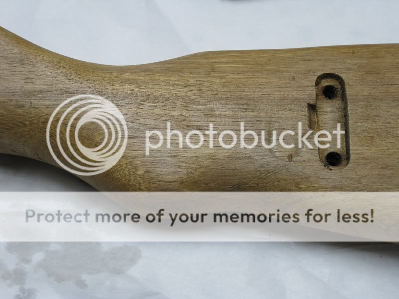

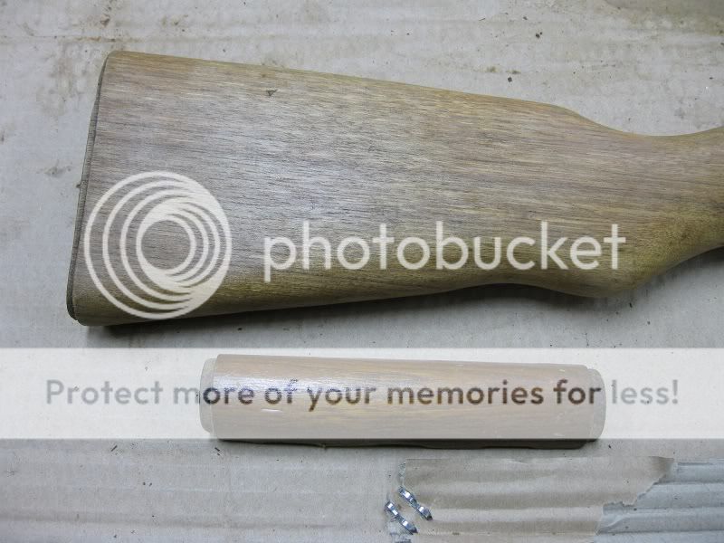

All done. I couldn't find my steel wool so I used an abrasive pad. Some areas needed a little scrubbing with the pad to get the old finish off. If you are dealing with some stubborn areas, use more stripper to wet the area and scrub away. It comes off without too much effort.

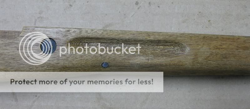

Even the finger groove came out great:
Pic showing the cleaned bayonet groove and the poor woodwork is pissing me off so I'll fix that later on.

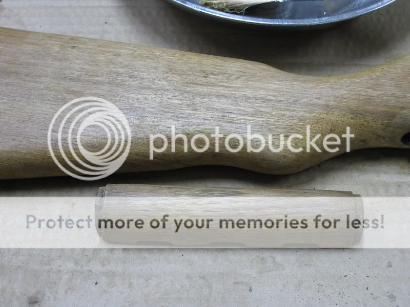

Another tip: don't forget to strip the upper handguard if you have it. :) I forgot about mine because I'm not using it anymore, but it's good to refinish it with the stock in case you decide to use it in the future.

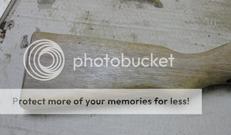

My forgetfulness was good because it shows the colour difference the original finish adds to the wood.
...and after:

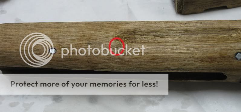

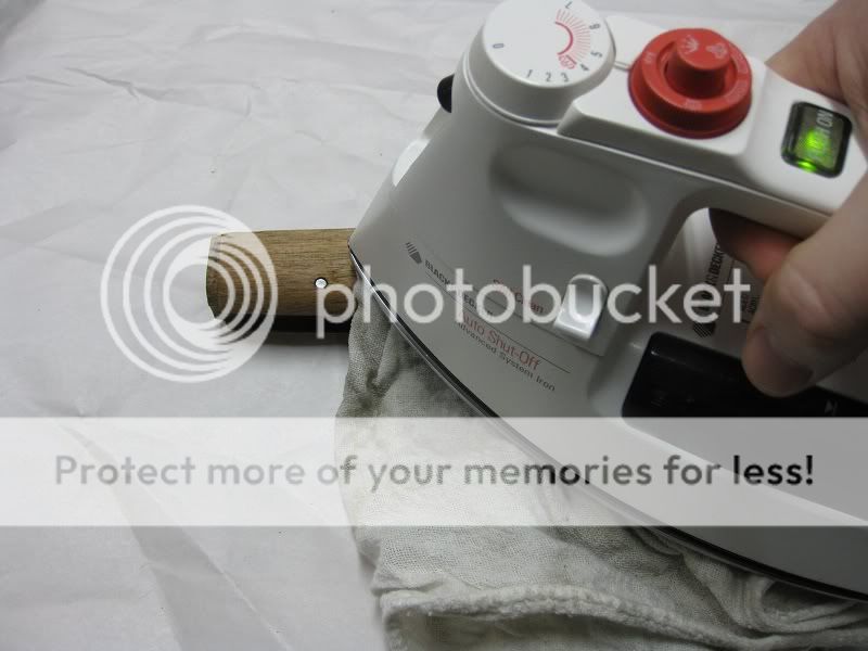

Once the finish has been removed, you may want to repair a dent or two in the stock. When wood fibres get crushed, you can often "inflate" them by driving steam into the wood.
Get a rag, some water and an iron. Wet the rag and lay it over the dent. Then hold the hot iron on the rag for 15-30 seconds, or until the rag mostly dries out. Remove the rag and see how the repair is progressing. Repeat until the fibres are puffed back up. If the dent is really deep or if the fibres are broken, it may never be completely level, but it will be better than before.
Let the wood dry, sand smooth to level the surface and proceed to more repairs and/or finishing.

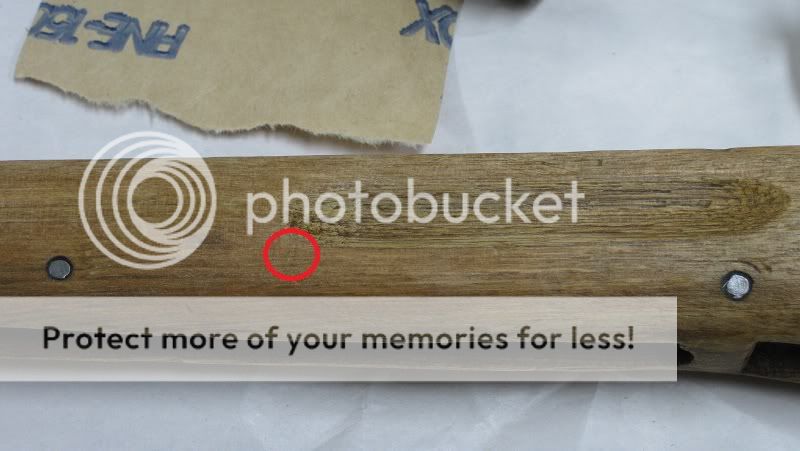

Before (dent in circle):
Wet rag in position:
Driving steam into wood:
Checking for progress (a little better, but needs more work):
Good enough for me!
Now to try out the large, deep dent from the swivel:
Getting much better!
