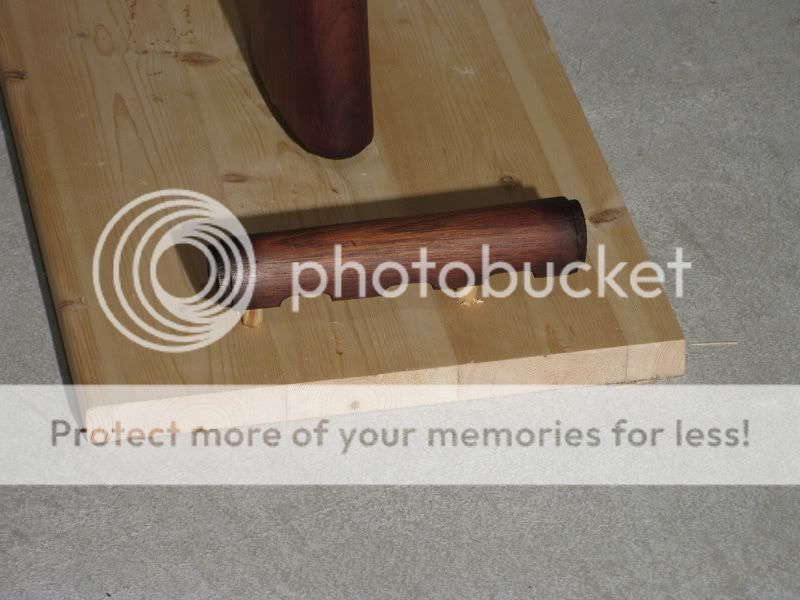

I decided to let the first coat of tung oil cure for almost two days because of all the existing oil in the stock. Since I wanted more red in the stock (this is a "red rifle" after all - lol!) I decided to play with stains.
Simple check: wipe some of the red-brown stain on my sample board of two different shades of tung oil. Since the tung oil will have filled up most of the pores in the stock, it won't allow the stock to turn super red. It will be very dark in the untreated wood on the board.
...and here it is.
Close up:
Now I need to let this fully dry before the next step. Once I'm done with the colouring, it'll be back to more tung oil until it's finished.

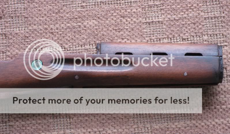

ok...I couldn't wait any longer and started playing with the upper handguard. :)
I bought some ebony (black) stain tonight. I was going to use my black artist oil paint as a colourant but decided to stick with a retail stain product because the oil paint has plain linseed oil in it and might take a while to dry. I'm tired of waiting.
So I mixed some black stain with my red-brown stain and after a little buffing with steel wool and then 5 mins of playing with stain, I came up with this. It resembles the (well-used) SVT-40 upper handguard I have with all the heat marks in the finish. I likey. :)

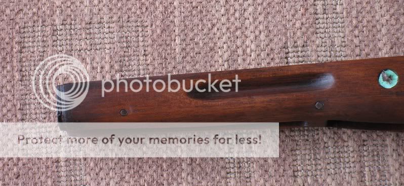

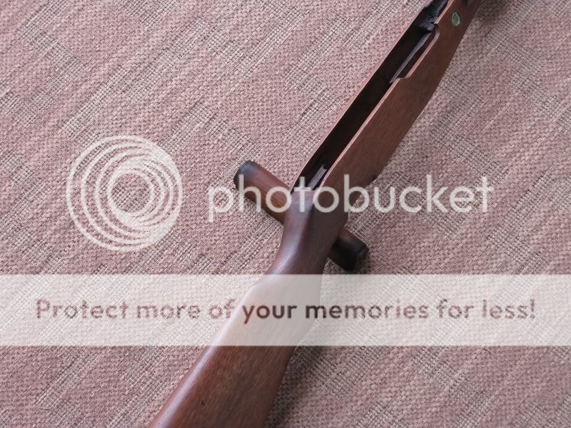

After playing with the stock I think "less is more" in this case. So I'm settling on just colouring specific areas. Areas I handle most often when I use it. Here are the latest pics, taken outside to get a little natural light on this very overcast day. The colour reproduction with this camera isn't the best, but it'll give you an idea.
If you want to remove a little colour, then give it a few strokes with some steel wool. To darken some areas to simulate embedded dirt/oils or heat marks, mix up a darker stain colour and dab little bits of stain on the wood and then wipe/blend the stain almost immediately off the wood. It will get progressively darker. It's easy to add more stain - and more of a pita to remove it cleanly. I have three layers on the grip areas.

One more tip: when doing any fine tuning with stains, take it real slow. See the stain flaw below in the red circle? The black line is a little heavy and stands out. All it took was literally 3 strokes with some steel wool to take the edge off and blend it in.
