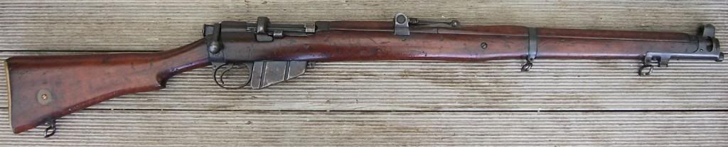

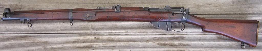

I am very lucky to own this 1913 made Canadian issue example.(Thank you Graham) Was wondering if BSA made these from the get go with the original rimfire barrel?
Or did a Canadian arsenal factory convert a once full bore rifle with a brand new barrel & firing mechanism??
I only ask because this thing has some ridiculous accuracy potential when lighting conditions are right at 100 & 200 yards. Superb sights with a very narrow front blade!
just curious here

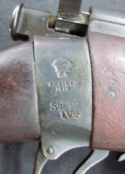

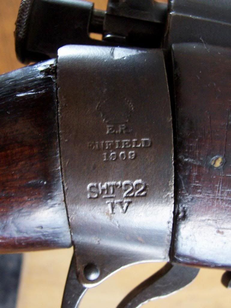

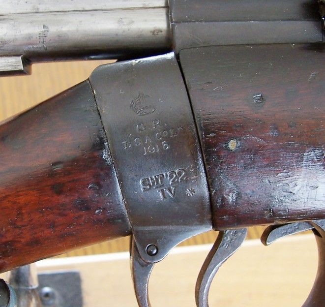

Factory conversions prior to 1926 when they were re named from Sht.22 MkIV to No2 MkIV* they were marked like this, the original factory & date remained but the original rifle designation was removed & the new one applied.
This is a NZ conversion done in 1927/28
Sorry can not tell you anything about Canadian conversions if indeed they did them

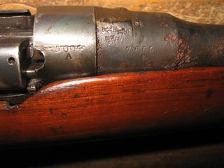

I have one that is not marked as a Sht.22 MkIV or No2 MkIV* but is built on a 1924 dated Enfield SMLE No.1 Mk.3 receiver with mag cutoff and with a not relined .22lr barrel. It has no Canadian or NZ markings and does not even have any import markings like "made in England" or British commercial proof marks.
It does have Enfield military proof marks although on the receiver and 1936 dated barrel.

Ian Skennerton states in his book that not all were stamped, just depends on when & where it was converted or if it was done post service
It appears from the many Enfield proof stamps on the underside of the 1936 dated barrel that it was done by RSAF Enfield. At least 3 are the same - a large D with a E inside over 22 (or E morphed into a D) which I take to be 3 times RSAF Enfield .22LR proof stamped. The E morphed into a D is also stamped onto the rear sight mount.

The proofs that I take for .22lr proofing are a large D with a E inside over the number 22. There are 3 of them in a line and row with other typical RSAF Enfield military proofs all under the barrel and Knox form.
No civilian or commercial proofs or markings on this rifle.
The magazine is a hollow box missing the follower and spring.

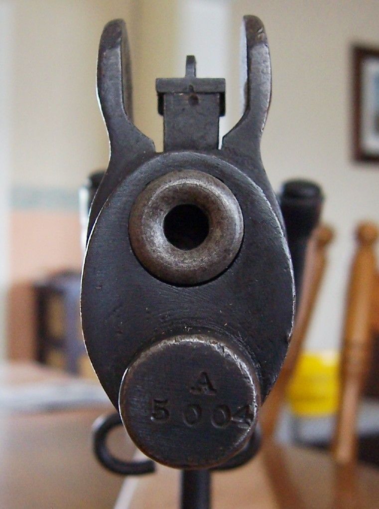

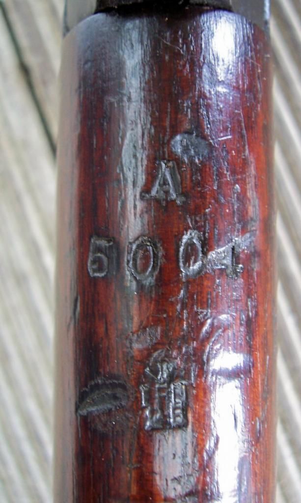

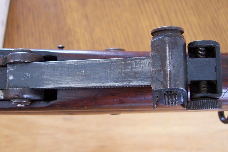

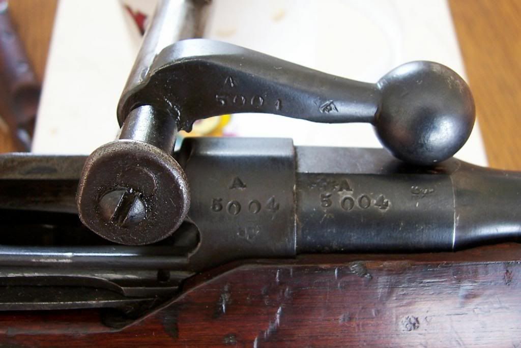

Here are some pictures, lighting is very bad in my basement with this cheap camera and this is the best I could get.

The mag cutoff works well to stop ammo and cases from falling into the mag and makes it easier to use as a single shot.
The super-imposed E over F over D came into use in or around 1925. Each factory inspector had a unique stamp identified by his number. In this case, RSAF Enfield inspector number 22.
The rifle looks right, I'd say that this is likely a factory conversion. Serial numbers match on anything?
And you are right, some of them are just tack drivers.

Why would they stamp the barrel with the identical factory inspectors stamp 3 times in a row?
Serial numbers do not appear to match on any part which is very confusing, even the rear sight and nosecap do not match.
Barrel is like new inside and out and of a much higher quality of smooth finish and a deep dark bluing unlike the rest of the rifle. It is clear that the barrel was blued separate from the rest of the rifle.
Rifle is in very good plus condition all over with very little finish loss. Even the very dark, almost black, walnut stock is in way better than average condition and remarkably free of dents and bruises.

"Why would they stamp the barrel with the identical factory inspectors stamp 3 times in a row?"
Not unusual. The factory inspector viewed three things, or one thing at three separate times. Building the rifle was a multistaged process with quality control at every stage.
I am not familiar with the markings on the butt disk. It does not follow the usual format of regimental markings. It might be a unit marking? Judging by the size of the lettering, it could even be a later marking of some organisation's or some person's initials. A good project for research.
After one hundred years almost, who knows where this rifle has been and who has worked on it. There is a story in there from when it was in service, and it has been in civilian hands for many years too.
A mixed serial number rifle is just that, it could have been put together or maintained by a unit armourer or even by a coach at some rifle club or school range. As long as it is 'in spec' it is a fine example. It is some collectors who sometimes make too much out of rifles having matching numbers. In service, the shooter did not care.
