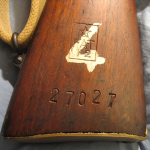

I had to look twice at the serial number.
Cool, I believe i know where there is another LE with the serial number 5004 but iirc no prefix or suffix, hopefully my mate still has it.

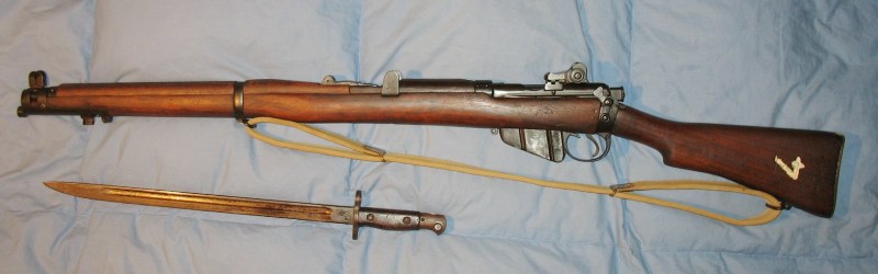

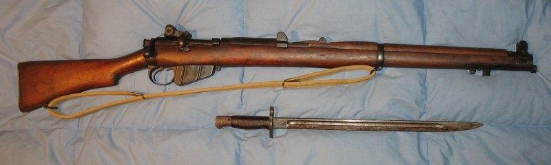

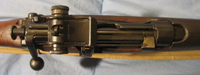

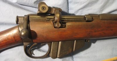

Has anybody seen one of these interesting SMLE conversion .22LR trainers before? -
So I guess nobody else knows about these .22lr SMLE trainers with M1 Garand sights?
Does anybody want to know more about their history and who modified and used them?
If I had to guess I would say something done in Greece or Italy?
Yes, Italy is the source, I thought someone would pick up on the PB (Beretta) marked front sight.

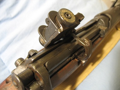

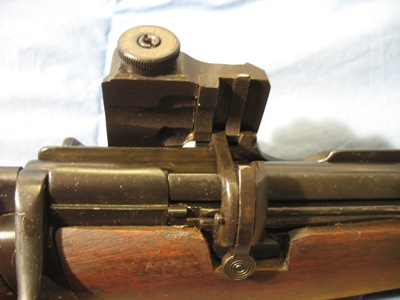

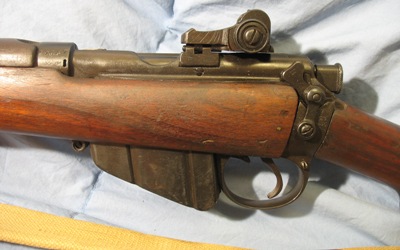

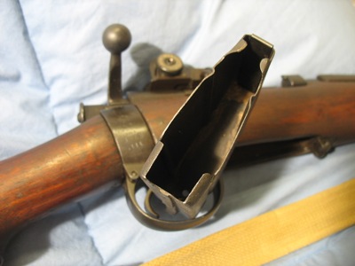

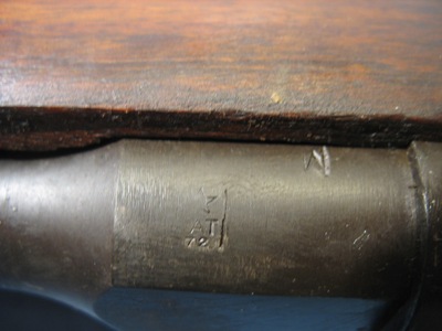

Here are some pictures I left out in the earlier post and a poorly translated from Italian text from a Italian book on them -

For ancient practice, from the beginning of 900 Britons distributed, together with their rifles, the trainer in .22 LR, which from 1926 took the name of No. 2 Mk IV. The same was done with the weapons assigned Italians.
So far nothing new. But strange things happen in Italy ... Just the arrival of the Garand, which determined the beginning of the end of the story of the British guns in our country, led to the birth of what can be called the only Enfield "Italian".
Apparently, someone thought that the system aims of the new US rifles were too innovative for the domestic servant, requiring the creation of a dedicated trainer version. He then arranged to take a number of No. 1 Mk III transformed into .22 caliber (delivered as such by the British or realized in Terni from some specimens now too worn out to still use the original size) and step on it the pin and the viewfinder of the Garand, without any change.
The result was a totally unique gun. The number of units built is not known, and maybe it's better that way, not to get too upset thinking to waste ... The transformation was in fact laborious and no doubt well-executed, thus resulting in disproportionately expensive compared to the hypothetical benefits.
Leaving out the steps needed to transform into a .22 caliber .303 for recycling, to convert a regular trainer in arming we are describing was in fact necessary to make changes to the receiver (and particularly to the bridge in the Mk III serves as a guide to platelets loading), the socket of the viewfinder and the mouthpiece.
All this, without even considering the reservations you may have the idea to train the use of a semi-automated using a bolt-action single shot and not be aware that the best way to teach her to shoot a Garand is ... to shoot a Garand.
