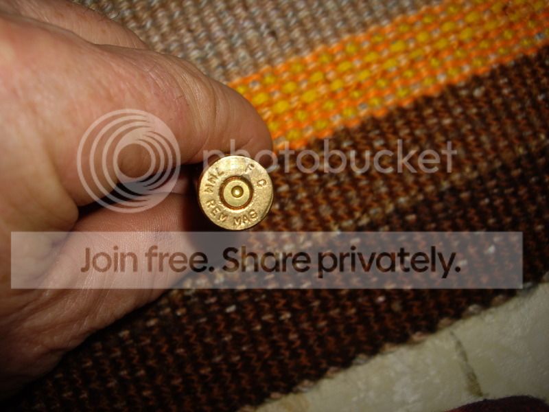

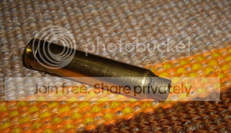

I have a 7mm Mag that was fired in a 300 Win Mag rifle ... very short neck, it has!! 270 fired in a 7mm Mag .. split like one of the ones above. None of my own yet, though....touch wood! Eagleye.
I was present when a individual fired seven rounds of 7mmremmag out of a 300 winmag. I was at the opposite end of the benches, and a friend mentioned that the rifle didn't sound right. We walked over and saw that the ends of the fired cases didn't look normal, so I asked him what his rifle was chambered in. When he replied 300winmag, I pointed out that he was shooting 7mmremmag ammunition.
What happened there Ted?
It was indeed fired in a 308 Norma Mag chamber. Compared it to a couple of my fired cases, and it is identical except for the short neck.
Odd thing is that I have made lots of 308 Norma Mag out of 7mm Rem Mag cases, however do anneal the brass before necking it up. The case in the picture must have had a pretty brittle neck/shoulder area.
Ted
