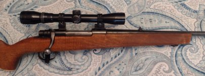

The first one is an interesting 4x37mm optic. Simple crosshair reticle, and the funky thing is an oblong field of view. Super clear and bright glass, great focus, but somewhat sensitive to sunlight light coming in from the front. Can anyone tell me... I mean my friend what kind it is? What were it's intended hunting scenarios and so forth? It came with my Husqvarna 1640, but currently it's mounted on my wife's 22.
The next one is a fixed focal length Bushnell Custom-DM 2.5X. This one came with my Husqvarna 1900, but is now mounted on my youngest's Rascal. It's got a T-shaped reticle, and it's also pretty bright. Sure would appreciate some info, or even a link to a manuel.

Fair enough. Really, I'm just curious about the 4X Tasco 667V clone.
What's the reason for the "panoramic" i.e. oval FOV. Is it to give you a bigger sight picture for acquiring your target?
I put that scope on the Savage Mk II plinker. We'll see how it does.
