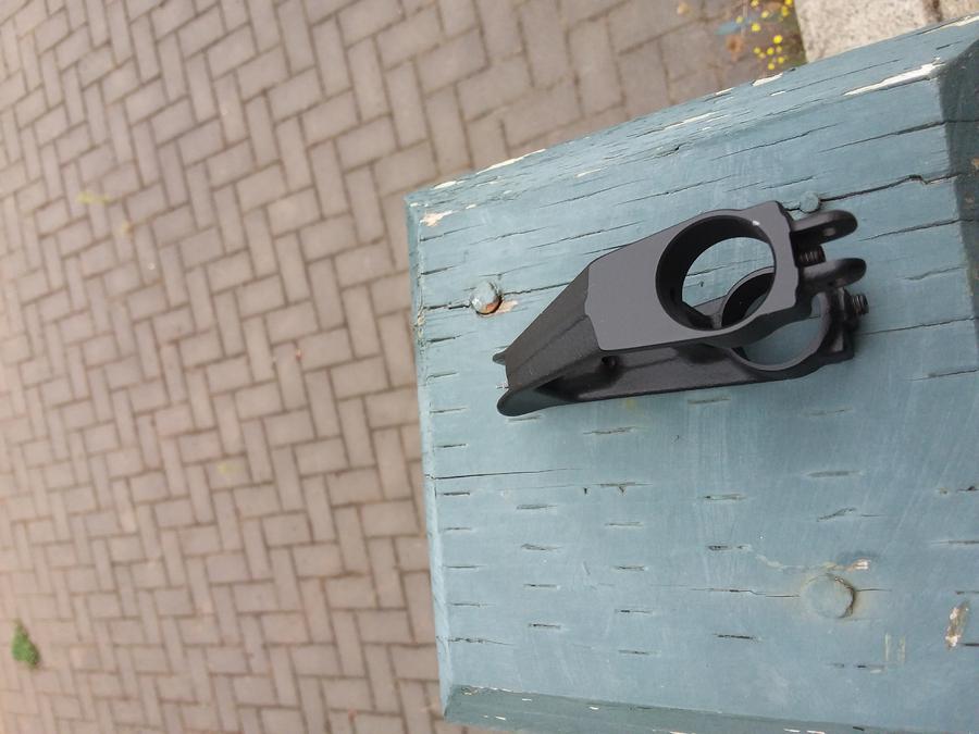

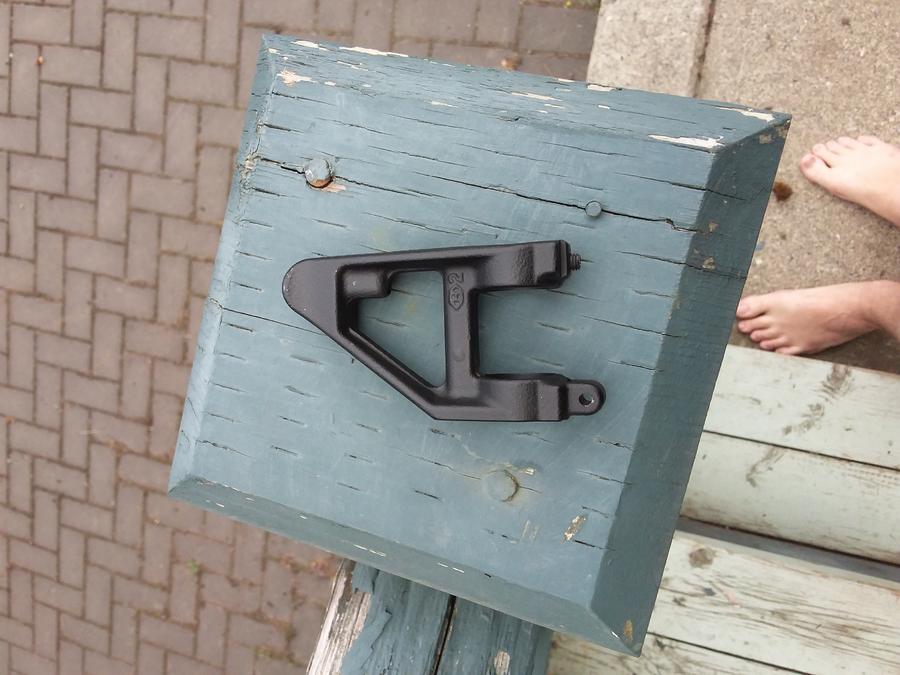

I took the hand guard off to see what was happening and sure enough there is a tiny fireball popping straight out of the gas tube! Maybe I got it right side up instead of upside down. What a dumbass Laugh2
Turns out I had installed the gas tube the way I wanted it - upside down. Looks like the gas didn't like being contained to cut a hole in the gas tube within a few shots, which is pretty wild. Gas tube wasn't new by any means so maybe there was some weakening of it, I'm not sure if that's a thing or not. I've got a handful of other brand new gas tubes- some stainless some nitride coated, but I'm not sure if I should just try another one the same way or try some other option. Tapping the gas hole might be a real pain in the butt as there is that circular plate that holds the handguards in place in the way. Maybe using a barrel with a A2 sight is more trouble than it's worth? Hopefully someone here that is smarter than me comes up with a solution. :)
We'll look at making some plugs. Should just be a matter of cross drilling a dowel pin. I think lots of people will want to use the A2 sight. We have yet to see this problem with the gas tube getting punched though, but there's lots of different gas tube manufacturers out there, so it's likely to happen to someone else.
If you want to restrict the gas Install the gas block backwards without the tube.
Hmm, makes me wonder if I should try again with a brand new gas tube. Although a solid plug would be a desirable modification.
This was the solution that I chose. Turned a plug, drilled it, then installed it with the roll pin. I should know later this week if there is any leakage.
Or you could just weld it shut.
