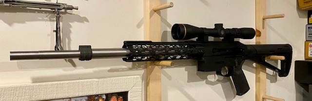

My LPC with a 20" 6x45 barrel. Had it out at the range on Friday, ran well, a few sticky extractions, but nothing serious. Im really liking this LPC platform, however it begs for a short barrel, i will likely land up putting a 10.5" 300 blackout barrel on it.
