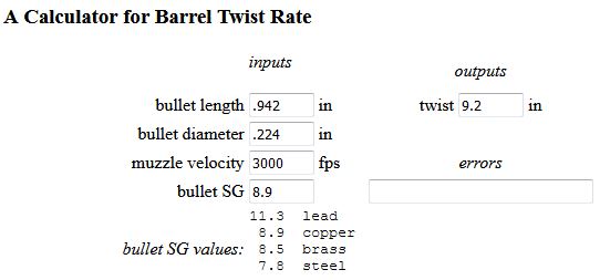

While browsing and doing the coffee thing...
[url=https://servimg.com/view/14116201/809][/URL]
There's other variables - like muzzle velocity for example... but according to Barnes and online twist calculators using the improved Miller twist rate calculator rather than the old Bowman twist formula, and the REALLY old original Greenhill formula developed for cannons, your 1/9 twist should be okay.
