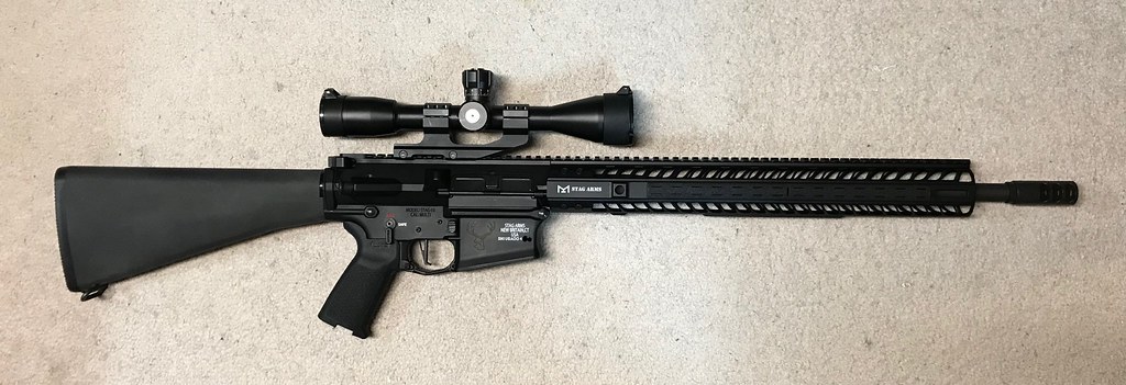

My Stag10.
I've only taken it to the range once so far, to test fire to make sure everything works as it should.
I have not sighted it in yet - still undecided what optics to put on it.
Forgot to mention, it's in 7mm-08.
