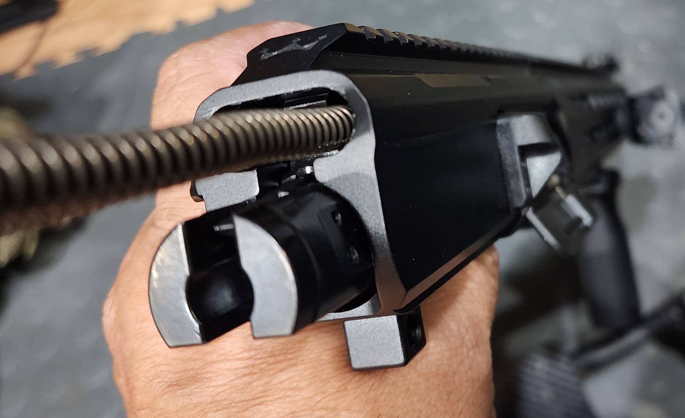

HANDLING
The Mk3’s balance point is directly in front of the Magazine Well, which makes for ideal weight distribution when carrying and shouldering the new rifle. When equipped with “iron sights”, the Mk3 feels very lightweight and quite lively in the hands. It is quick to point and thanks to the familiar AR15-style ergonomics is comfortable and natural to point at a target. The cheek-weld and head-height are both excellent for both Irons and Optics and can be further adjusted up or down using the 3-slot Picatinny Rail on the Rear of the Lower Receiver.
The Mk3’s action slides very smoothly on two steel Guide Rods nestled within the top of the Upper Receiver. Each of the Rods “guides” an Operating Spring, the combined force of which closes the Bolt Carrier forward against the Barrel Trunnion with the rotating Bolt locked into the Barrel Extension. The curved Bolt Carrier body is guided during its back and forth movement by the matching curved Receiver Walls. The Bolt is hardened Stainless Steel with a single Ejector and a standard AR15 Extractor. The Rotating Bolt is controlled by an AR15-style hardened Stainless Steel Cam which follows a slot in the Bolt Carrier to lock and unlock the rifle’s action. Over-pressure Proof rounds are fired as part of the pre-shipping Quality Control checks and inspections.
Mk3 Bolt Carrier Assembly Riding Inside of Upper Receiver

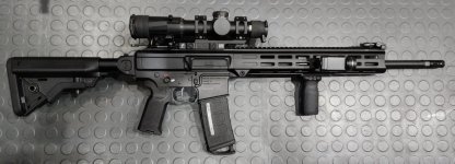

EXAMPLE BUILD
Below is an example of a utility build based on the R18 Mk3. The list of additions is detailed below:
- EoTech VUDU 1-10x Low-Power Variable Optic in American Defense "Recon" QD Cantilever Mount
- RiteOn Miniature Red Dot Sight on Offset Mount
- Midwest Industries Iron Sight Set
- Streamlight TLR-HL White Weapon Light
- Magpul Vertical Foregrip
- Magpul MOE Pistol Grip
- Strike Industries Ambidextrous Magazine Release
- BCM QD Slot for Sling Swivel
- B5 Systems SOPMOD Buttstock
- Magpul Windowed 5/30 Magazine with Ranger Plate
