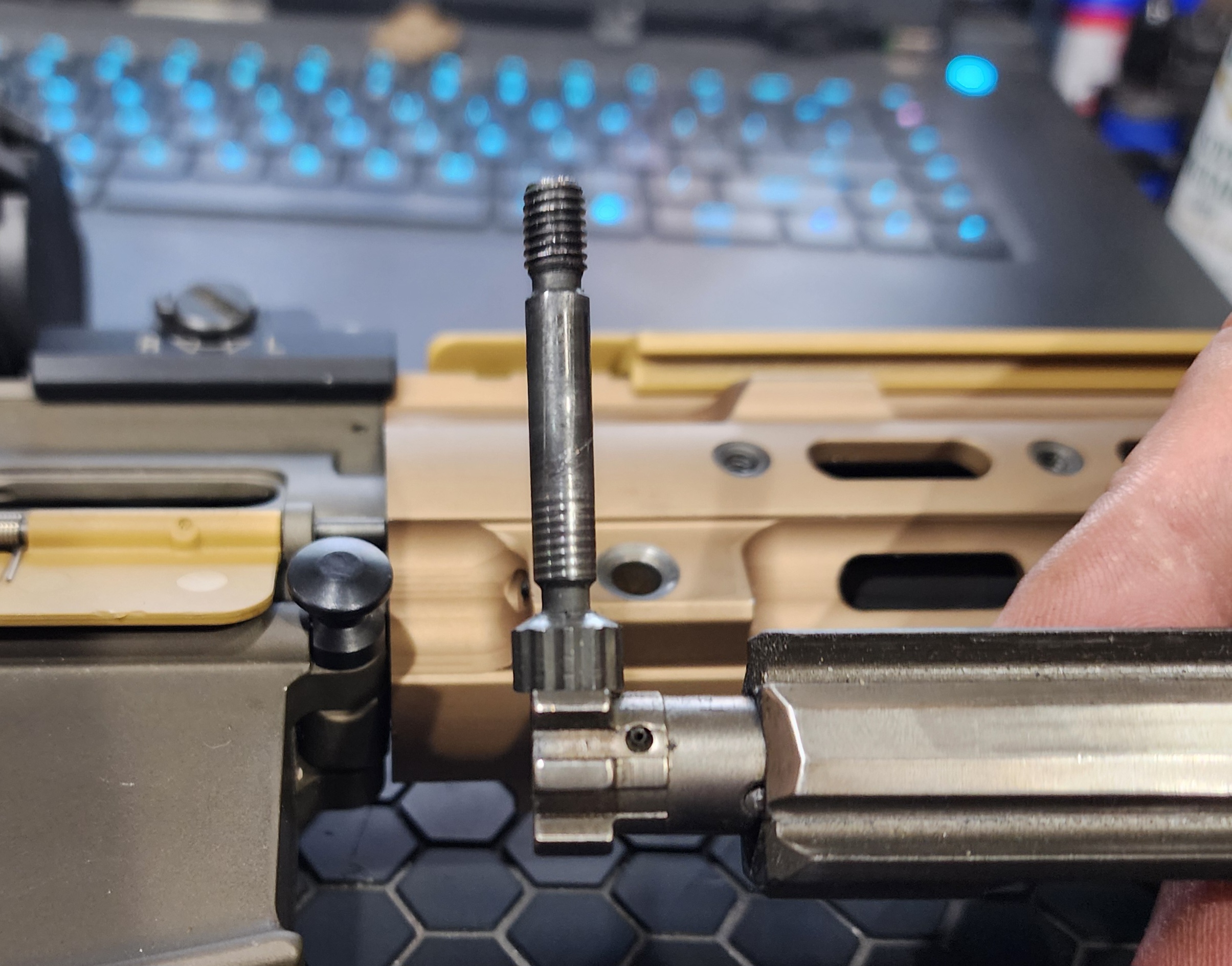

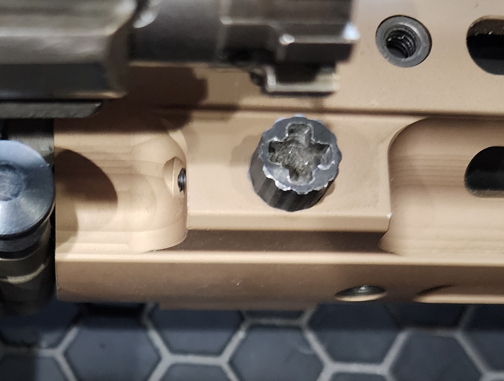

Here is what I am talking about, a picture being worth 1000 words.....
The Handguard Retention Cross-Bolt and the Bolt-Head Locking Lugs that are used to loosen the Cross-Bolt.
The Handguard Retention Cross-Bolt perched on one of the Bolt-Head Locking Lugs used to loosen the Bolt.
ETA: The Handguard Retention Cross-Bolt also accepts a flat/blade screwdriver if you don't want to use your Bolt's Locking Lugs....
